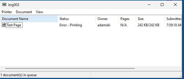

A service we will be starting to use shortly requires a printer server with IPP/IPPS enabled on it to print securely. I have setup a Windows Server 2025 server with the printer server and Internet Printing enabled. After adding a network printer to the print server I can do a test print, but when I try to attached my PC on the network to use the w2k25 print server's printer the test print goes to the queue and just says ERROR. Can't find anything to tell me why it is failing. No logs, no useful info in the event viewer.
Only thing I noticed is the setup for IPP printed says you have to download the printers certificate and place in Third Party Root Certificates. However it get auto-deleted by the OS. I tried placing the certificate in the Root and Personal folders, no help. Don't even know the certificate the problem.
If anyone has setup a Windows Print Server with IPP printing, can you give me some help in identifying why nothing from any device other than the print server errors out.

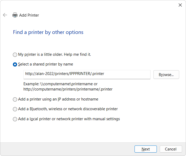

    Let's get you started with the connection to the server over IPP first.
    On a Windows 11 client, open Settings / Printers & scanners. Click Add Device and after a couple seconds you will see a new link called "Add a new device manually"
    You can skip all this crap by opening an elevated command prompt and executing printui /il
    You will see the Add Printer UI
    Click "Select a shared printer by name"
    Enter the http connection string. My server is called ALAN-2022, the printer share is named IPPPRINTER.
    The connection string is http://alan-2022/printers/IPPPRINTER/.printer
    You will be prompted for drivers so use the same one you have on the server. When both machines are domain joined, you might just get the driver from the server.
    I grabbed the "HP LaserJet Flow MFP M527 PCL 6" from Windows Update.

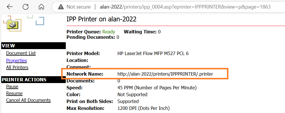

    You can also get the connection string by opening a browser and going to http://printservername/printers

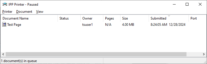

    I paused the printer on the server and sent the Test Page.
    All set.

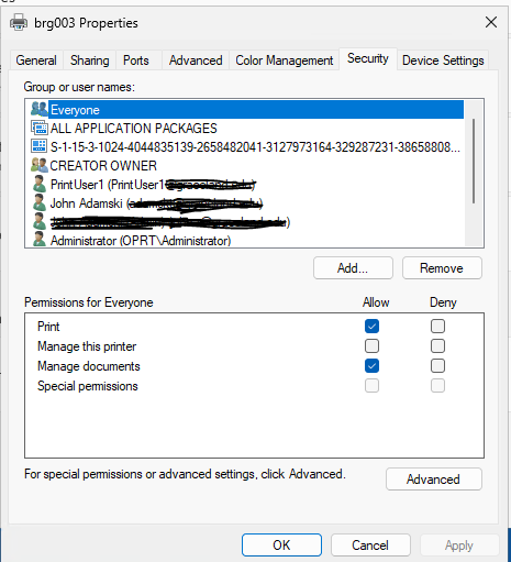

    Hi @John Adamski I never got a message you responded.
    Great that you got the job to the server using IPP.
    Your user name came through so Windows is getting the correct user name over IPP.
    At this point, it just getting spool file on the server to go to the printer, correct?
    Error - Printing is a writeport failure to the hardware. I am guessing you have a Standard TCP/IP Port to the printer hardware, correct?
    If you are using some other port, can you provide those details?
