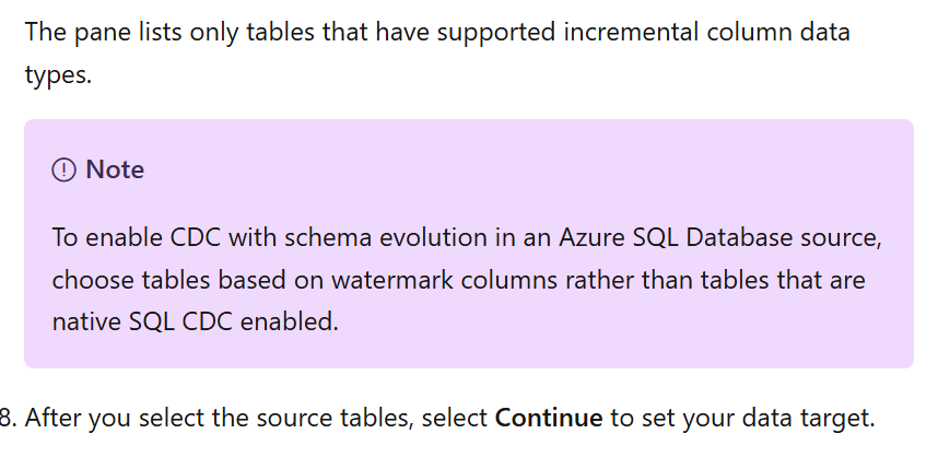

But this table is not detected in the pane list of source table. As per MS doc, The pane lists only tables that have supported incremental column data types. But this table has Person Id of int data type which is incremental data only. What are all the supported data types ?

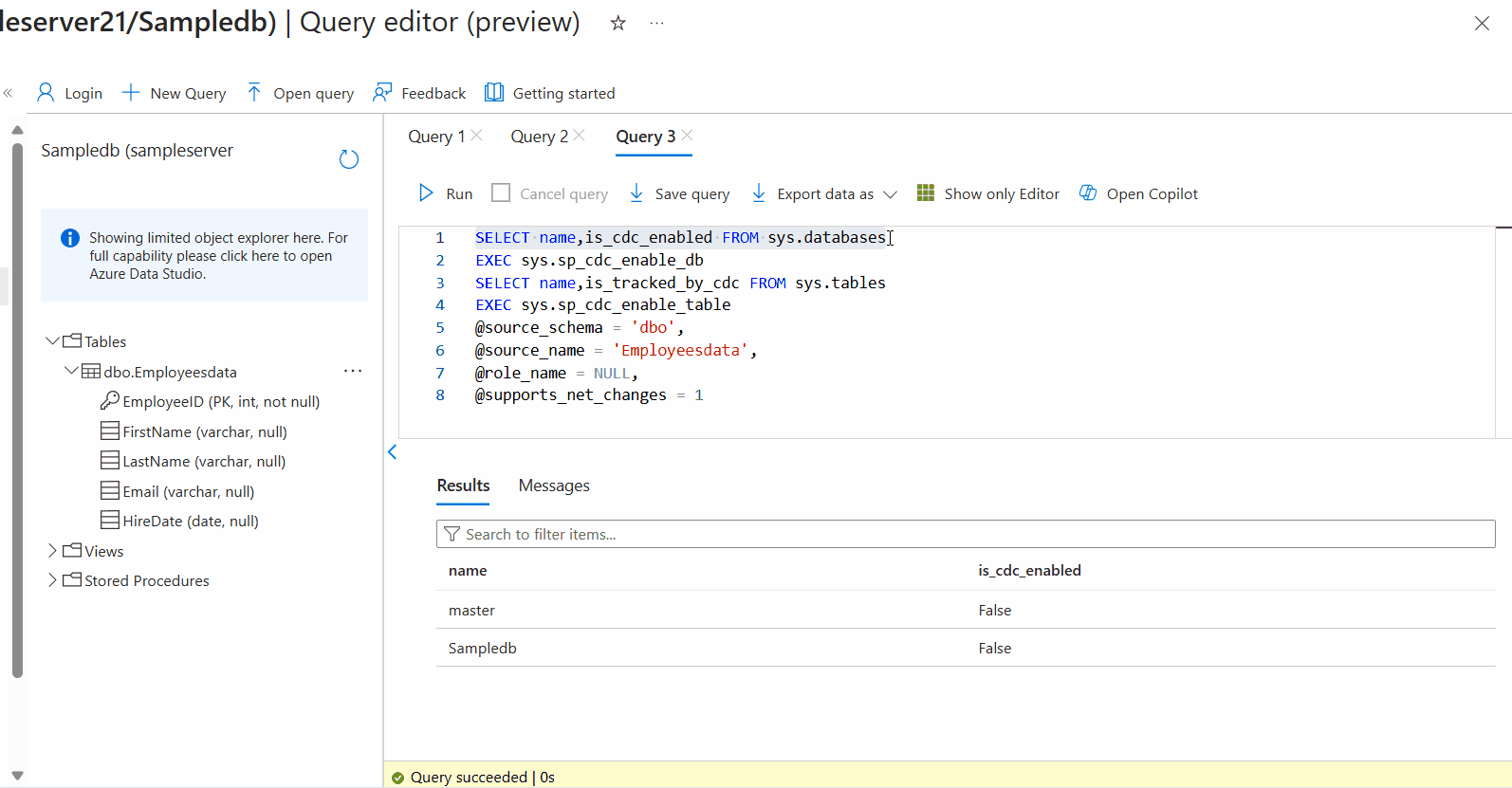

    Regarding the detection of the EMPLOYEE table in Azure SQL Database for Change Data Capture (CDC). Based on the information you provided, it seems that the PersonID column, which is of type int, should indeed be a valid incremental column type for CDC. The int data type for PersonID is indeed supported for CDC. In fact, the schema you have provided (int, varchar(255), int) is compatible with CDC, as all these data types are supported.
    However, there are a few key factors to consider that might explain why the table is not appearing in the source table list:
    Primary Key Requirement - CDC requires that the table has a primary key defined. Please ensure that the EMPLOYEE table has a primary key constraint on the PersonID column.
    CDC Enablement - Make sure that CDC is enabled for both the database and the specific table.

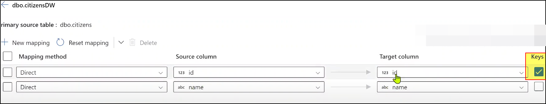

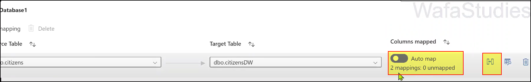

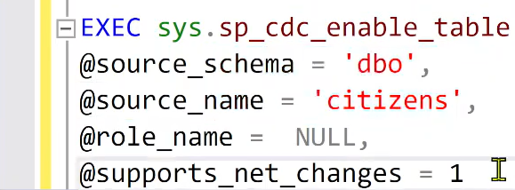

    CDC gets enables on a table , not on any column . Below is the SQL script to enable the CDC.
    Once the CDC is enabled in SQL, you can disable Automapping and perform mapping manually and select the relevant column as 'Key column' . Checkout the images below:User's image
