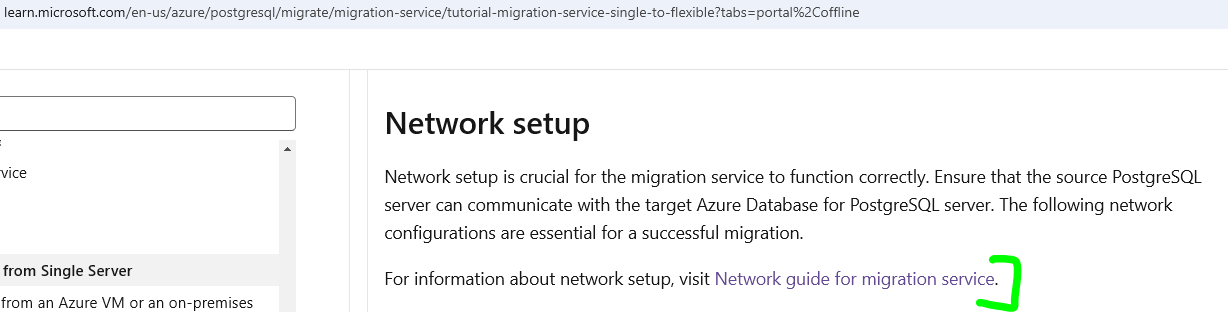

For Azure Database for PostgreSQL Single Server...The migration process needs to be performed to move it to the Flexible Server service. Supported network scenarios for migration are discussed here...
https://learn.microsoft.com/en-us/azure/postgresql/migrate/migration-service/how-to-network-setup-migration-serviceUser's image

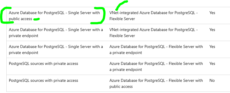

For a Single Server configured with a public "postgres.database.azure.com" (FQDN) address, What migration path to select for a Flexible Server that would also end up needing a public "postgres.database.azure.com" (FQDN) address? The options provided in the link above only seem to support Flexible Server with VNet or private endpoint.

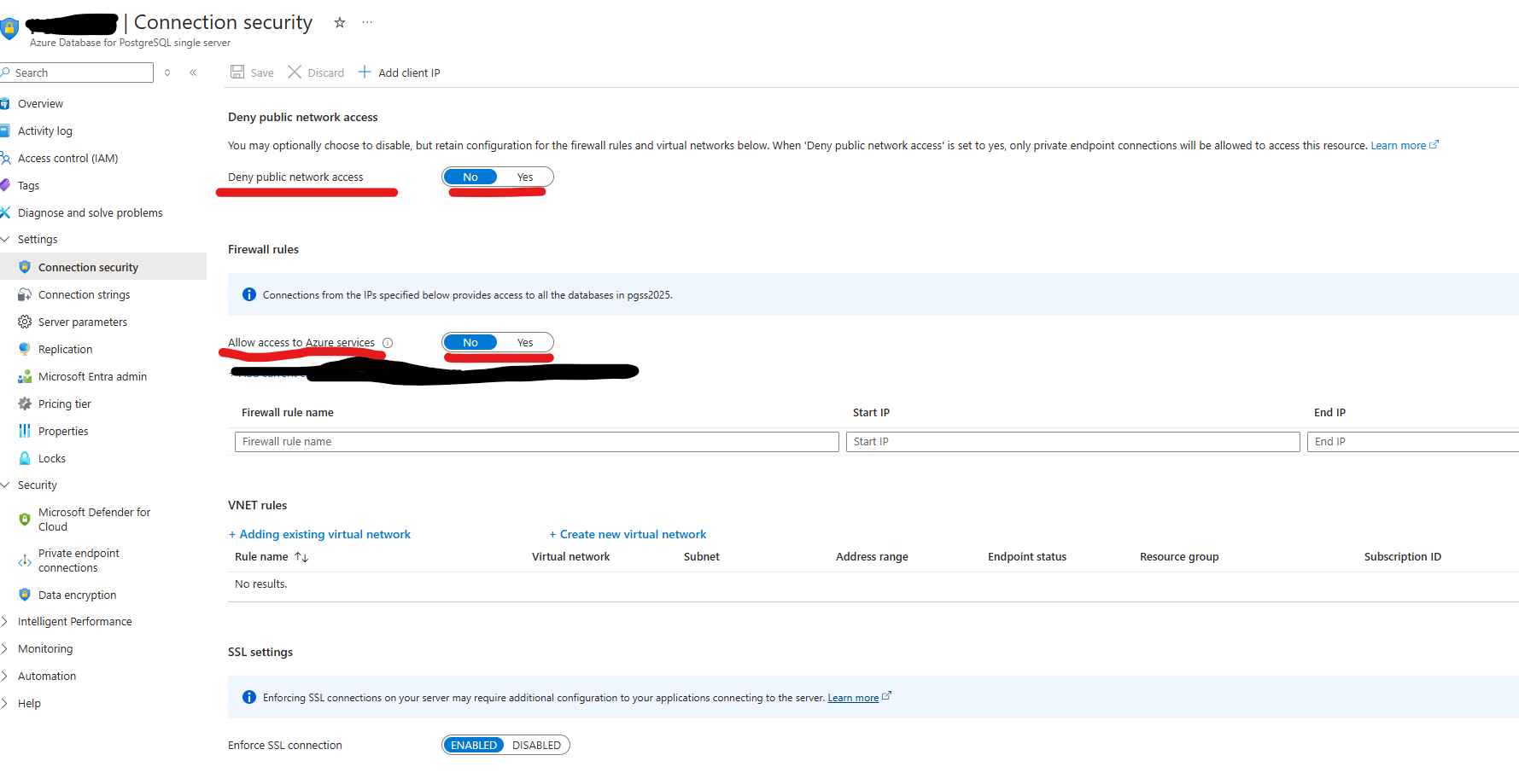

    Any feedback regarding my last comment regarding which network scenario applies to my deployment?
