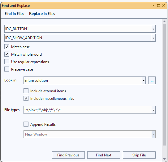

Side issue:  Used ctl-h to replace all, but the dialog does not have a button to actually replace.  This was quite surprising.  Changed all the names in the entire solution by searching them out one at a time and use ctl-v to replace.  That seems to have worked.  Will this cause problems in the future?  I suspect there is much better method.
find_replace
There is no button for the action of "Replace" or "Replace All"

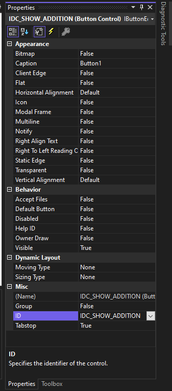

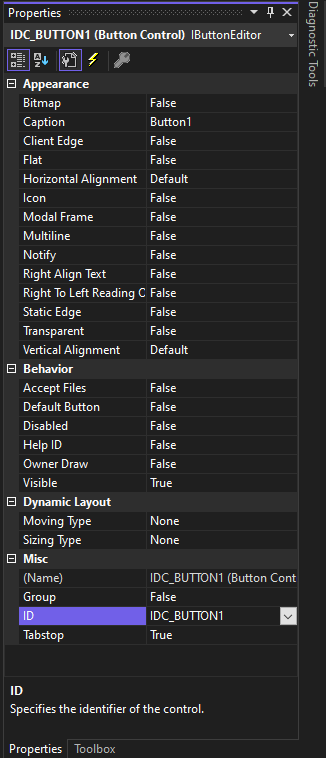

    In the properties pane for the button control change the control's ID. Your change will automatically be reflected in the Misc group (Name) field. There is no need to use Find/Replace.
    Before -
    BeforeProps
    After -
    AfterProps
    Don't forget that code refers to resources by their IDs.
