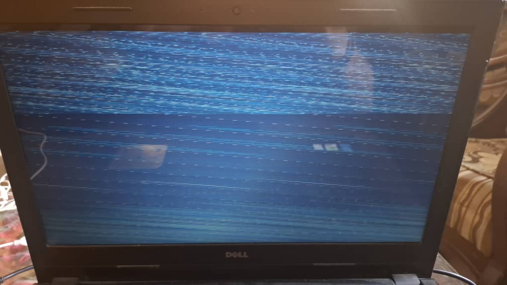

I installed Parrot Security next to Windows, but when the Grup menu appears and choose the Parrot, it works well, but if the Windows 10 is selected, the system does not work and the screen remains like this 1000165740
I also tried using grub command and boot repair disk but it didn't work!!
