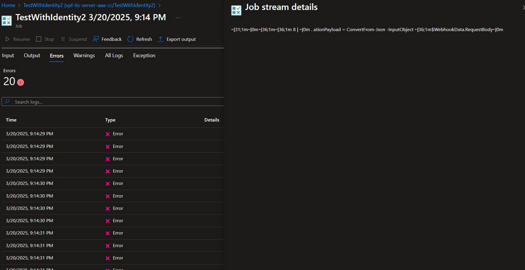

The runbook is configured to be triggered by webhook as a "pre-event" for Azure Update Manager.
When I test in the "test pane" with an example webhook from a failed job in the logs, the script runs correctly.
When it is triggered during the update process, the Webhookdata gives :
Capture
NotificationPayload = ConvertFrom-Json -InputObject $WebhookData.RequestBody
Cannot bind argument to parameter 'InputObject' because it is null.
I tried using snippets directly from Microsoft Learn documents, they didn't work either!

This has been haunting me for over a week now, does anyone have any insight on how to get this to work?
OH! also, if there's any tips on how to fix the error/output stream to not generate all those "[" and split the logs into 24 inddividual log entries, that would be really appreciated too.
