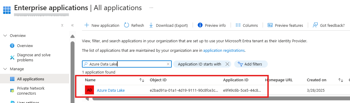

    Once you run the above commands, verify that the service principal was created successfully:
    1. Navigate to Microsoft Entra ID
    2. Go to Enterprise Applications
    3. Remove Application Type = Enterprise applications filter
    4. Search using the App ID (e9f49c6b-5ce5-44c8-925d-015017e9f7ad) or App Name (Azure Data Lake)
