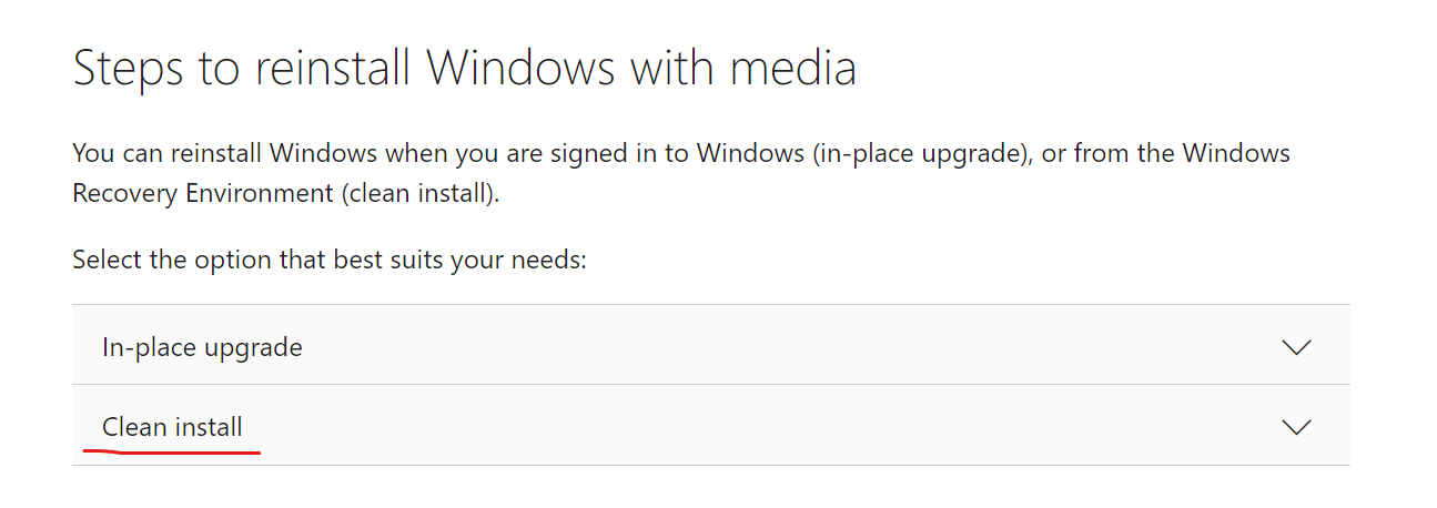

    If you notice coming directly from System, then I recommend that you back up all your important data and use the installation media to install Windows all over again:
    Reinstall Windows with the installation media - Microsoft Support
