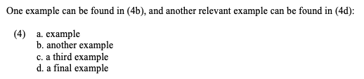

I am working on a document with many auto-numbered examples and cross-references. The format should be as below:
I am struggling to get this to work with examples that have multiple levels on one line. There are two issues:
  1. I haven't found a great way to get multiple examples on one line within one format. Right now, the (4) is from the auto-numbering, and the alphabetical list is from a LISTNUM field. This (maybe hacky) system is fine, but if there's a better way, I would love to know! I tried to create a new List Style that would have multiple levels on one line, but then it doesn't continue numbering from previous examples that don't have multiple levels, which is a necessity.
  2. Following from my solution for (1), when I insert a cross-reference with full context, it appears like this:
I don't know why it uses 1 instead of 4, and I don't know how to get it to format like (4b) instead of (4)b.

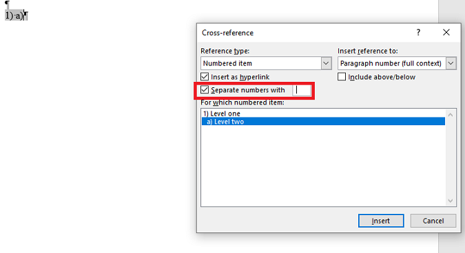

  1. Stefan Blom 340.3K Reputation points MVP Volunteer Moderator
    2020-01-12T21:35:08+00:00
    Sorry, Word doesn't let you decide where the separators should go. What you can do is add an extra space, if you find that doing so makes the reference easier to read, by adding a blank space in the "Separate numbers with" box in the Cross-reference dialog box.
