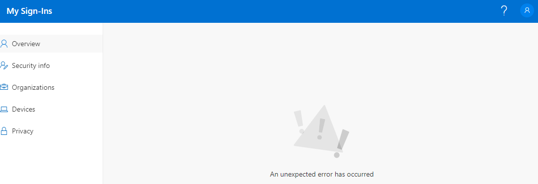

When I used my 365 account to navigate to page: https://mysignins.microsoft.com/security-info
It shows the following error:
An unexpected error has occurred

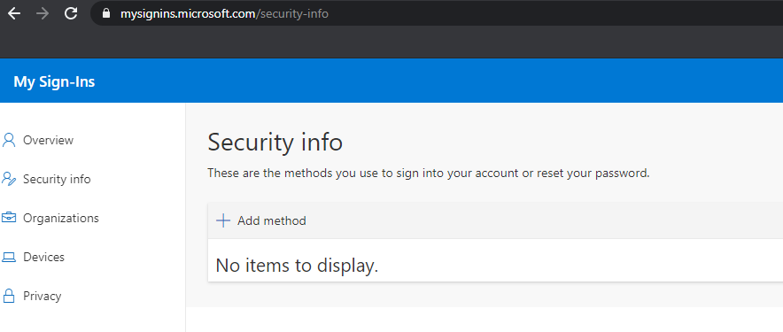

Thanks for your post with above details. I just tested this on my side and I can access the site you mentioned without any errors, please see:
Given this result, please kindly try it again with a different browser and the browser's InPrivate mode to see if there is the same result.
