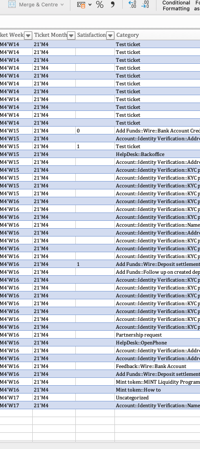

I have a column called "Satisfaction", where 0 is for a bad rating, 1 for a good rating, and empty for a non-rated support ticket.

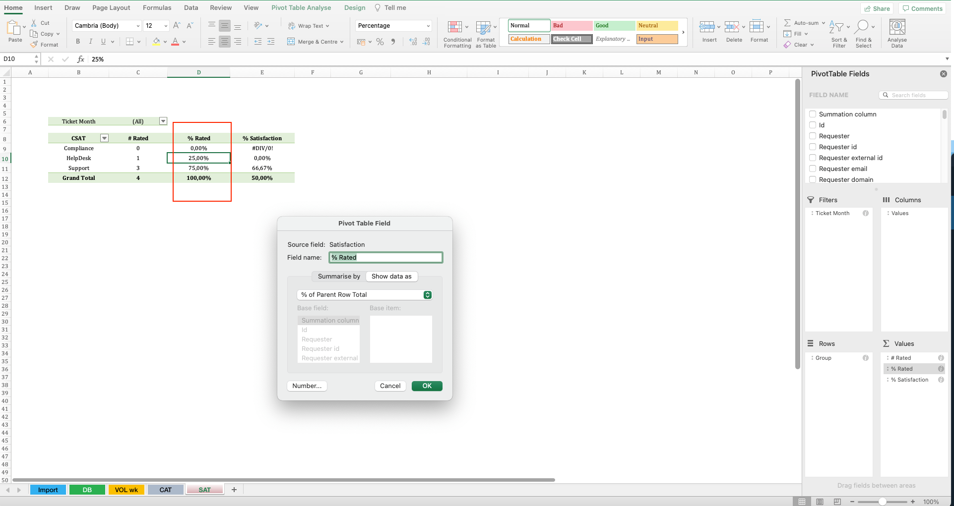

I wanted to create a pivot table (check images below), with the following columns:
  • Rated
  • % Rated
  • % Satisfaction
But not getting the results that I wanted. The % satisfaction is ok but I have the DIV/0 situation to solve.

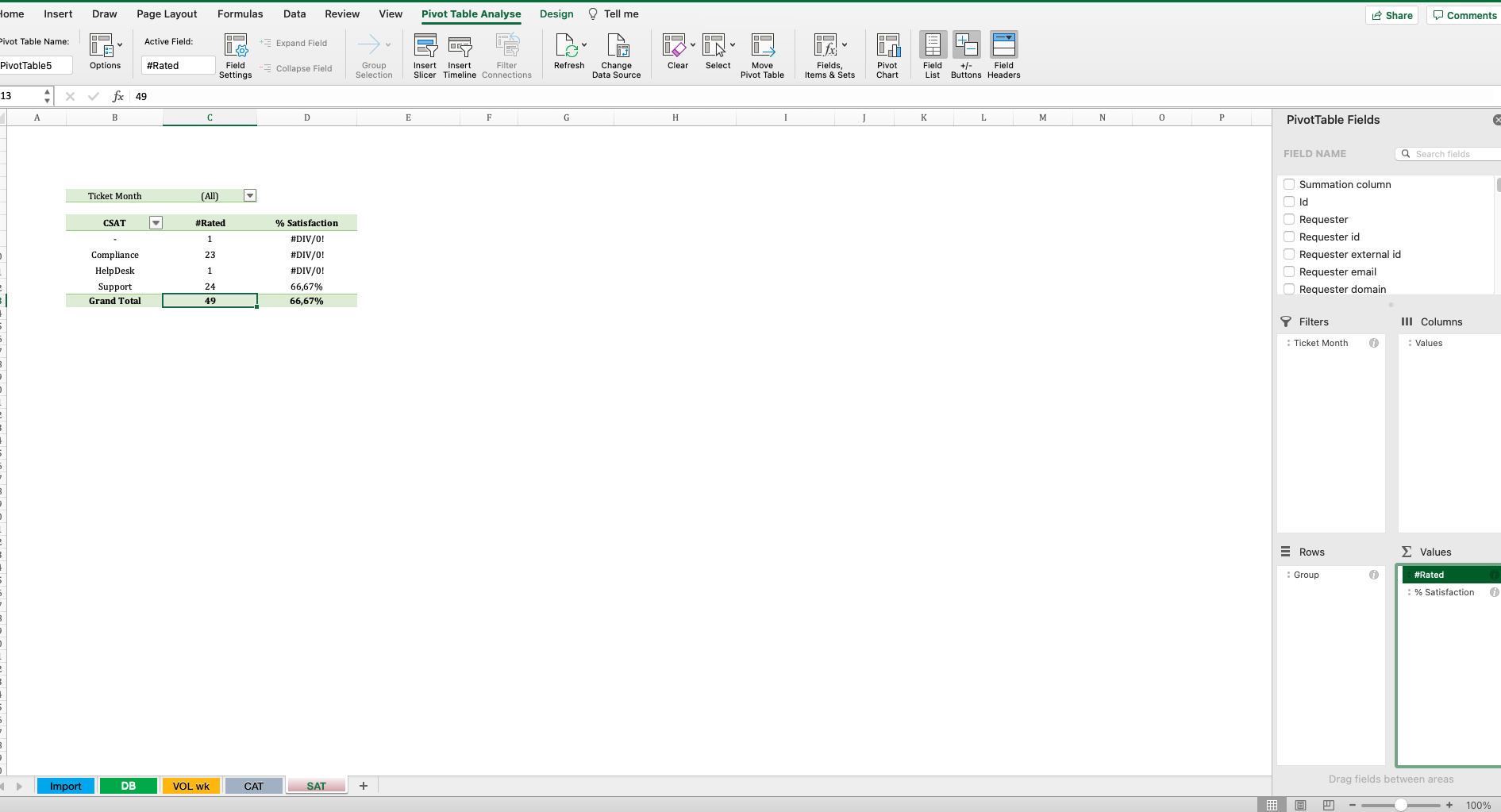

The #Rated, not getting is with count or sum, because count, counts all rows, and sum only good ratings.
Any thoughts on this?

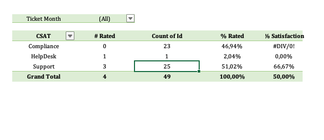

    2021-04-26T21:21:01+00:00
    Thank you Cliff.
    It's not quite that. That way, the "% Rated" column retrieves the % of dis distribution of the "# Rated" column.
    What I want to get is the % rated of all rows (in this particular case "support tickets").
    I have 49 tickets, 4 of those tickets were rated, 3 for support, 1 for Helpdesk .
    The rated ticket for "helpdesk" is Bad (0), and for Support 2 were good (1) and one bad (0)
    % satisfaction for Helpdesk is 0%, 1 rated ticket, and the % rated should be 2% (1 / 49)
    For support, the % satisfaction is 66,67%, and the %rated ticket should be 6,12% ( 3 / 49)
    Can't find a way to get the %rated
    I added the "count of id" (total ticket count) for better perception, but if it can help to calculate the %rated I can leave it in the pivot table
    2021-04-26T19:39:36+00:00
    Dear Pedro,
    Welcome to the forum here.
    Generally, you can just change the #Rated filed settings by clicking on Field Settings>Count>Show Values As>% of Grant Total to see the result.
    If something is misunderstood, welcome to share any updates when you have time.
    Best Regards,
    Cliff
    2021-04-26T15:54:24+00:00
    To resume, for % Rated, I would like the % of rated tickets, without having to add a column for the total count ..

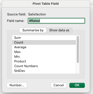

    2021-04-26T14:49:38+00:00
    Ok found it for #Rated, its "count numbers"
