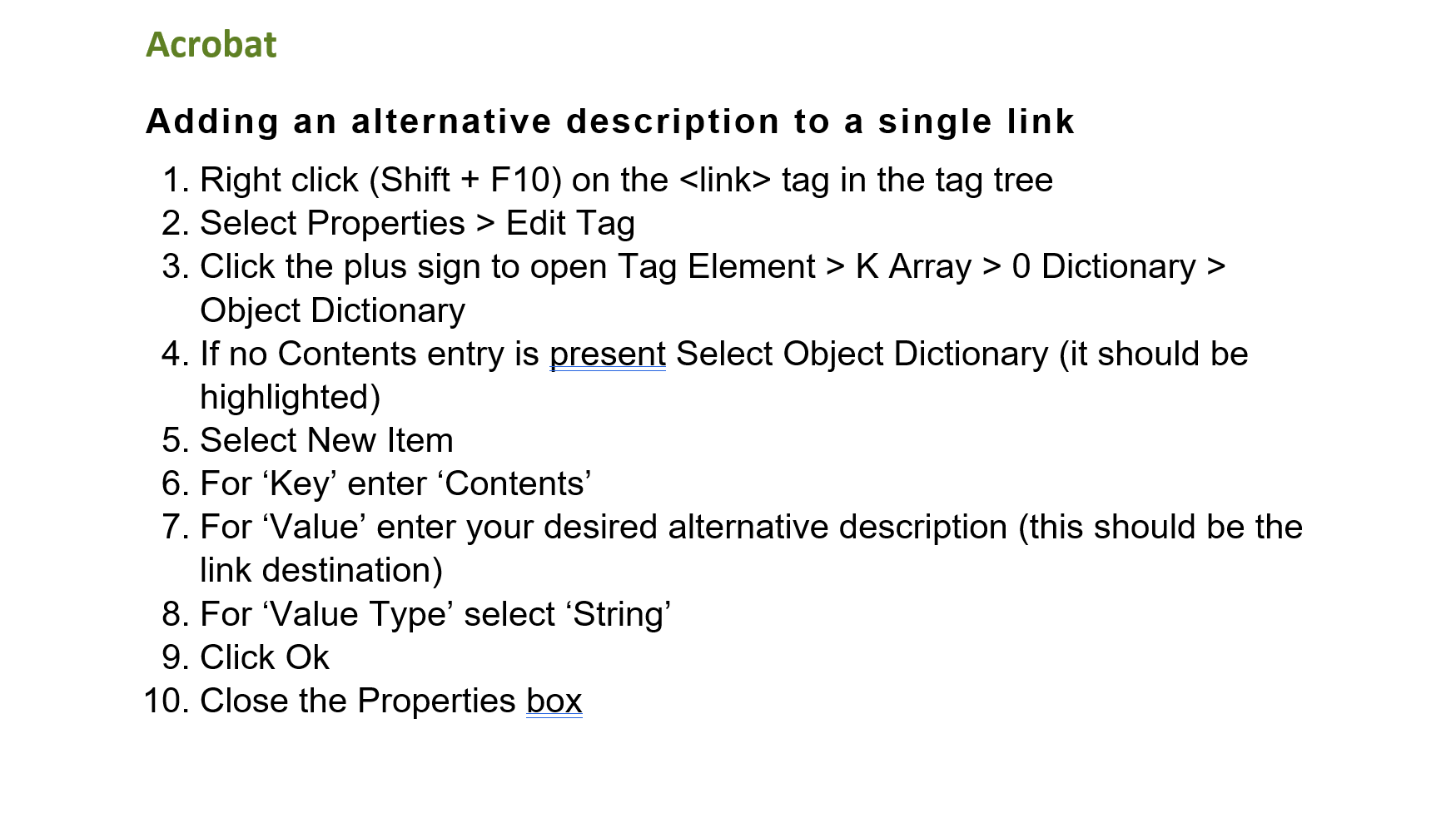

I'm running into a problem with the formatting of numbered lists in Word. I've put together a solution - some of it based on advice I've found here. I'll detail my solution below. My question is: is there not an easier way to do this? This seems like a very complex solution to what isn't a terribly complex problem.
Here's what I'm running into: When I create a numbered list using the numbered list option under Paragraph on the Home tab, if that list goes into two-digit numbers (10 and above), the spacing becomes irregular for numbers 10 and above. That is, there is a large gap between the two-digit numbers and the list item text. (See screenshot 1)

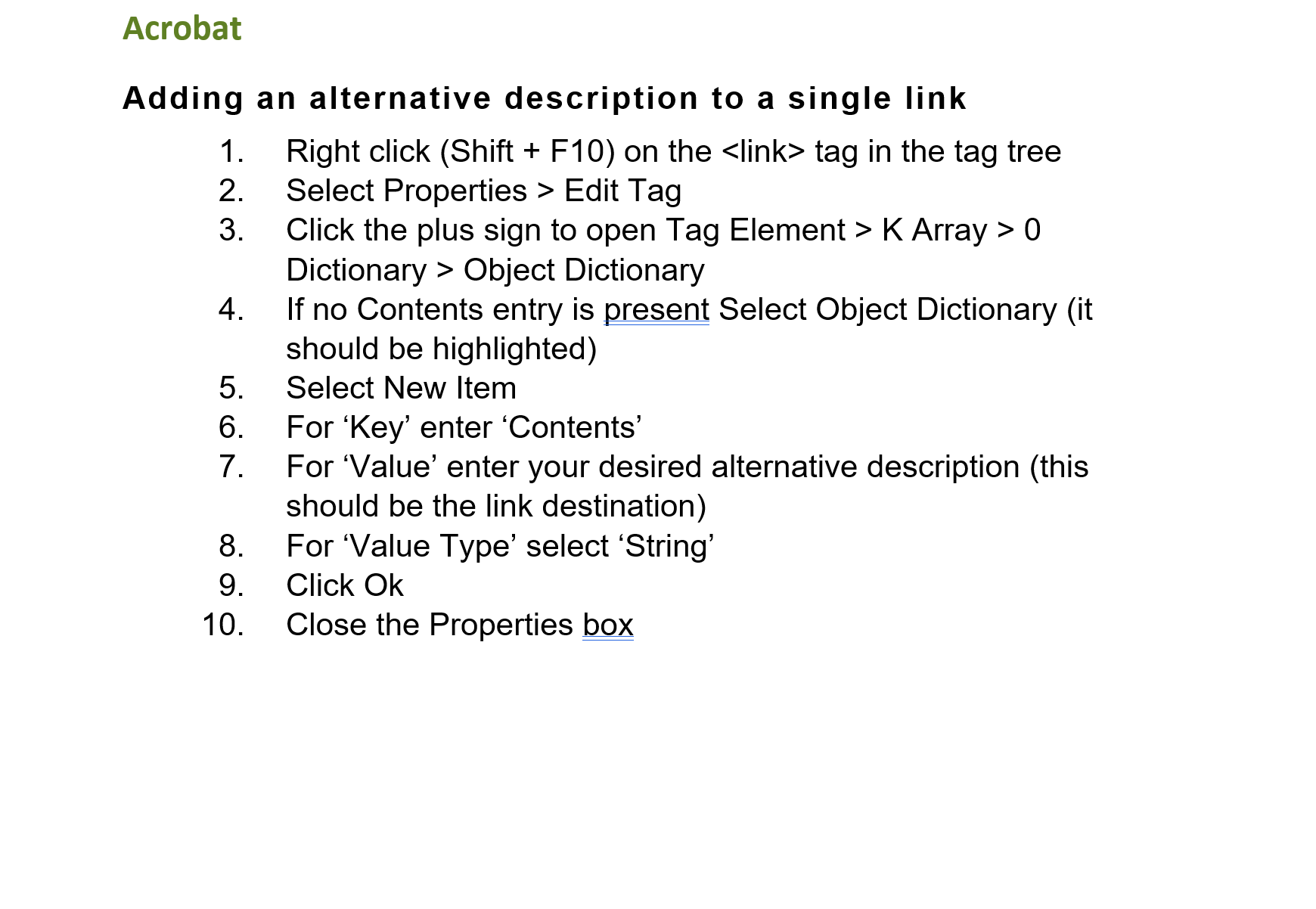

I can correct for this by selecting ‘Define New Number Format’ and selecting ‘Right’ under Alignment. This gets rid of the huge gap next to the two-digit numbers. However, this results in abnormal indents and spaces that I want to correct. (See screenshot 2)
