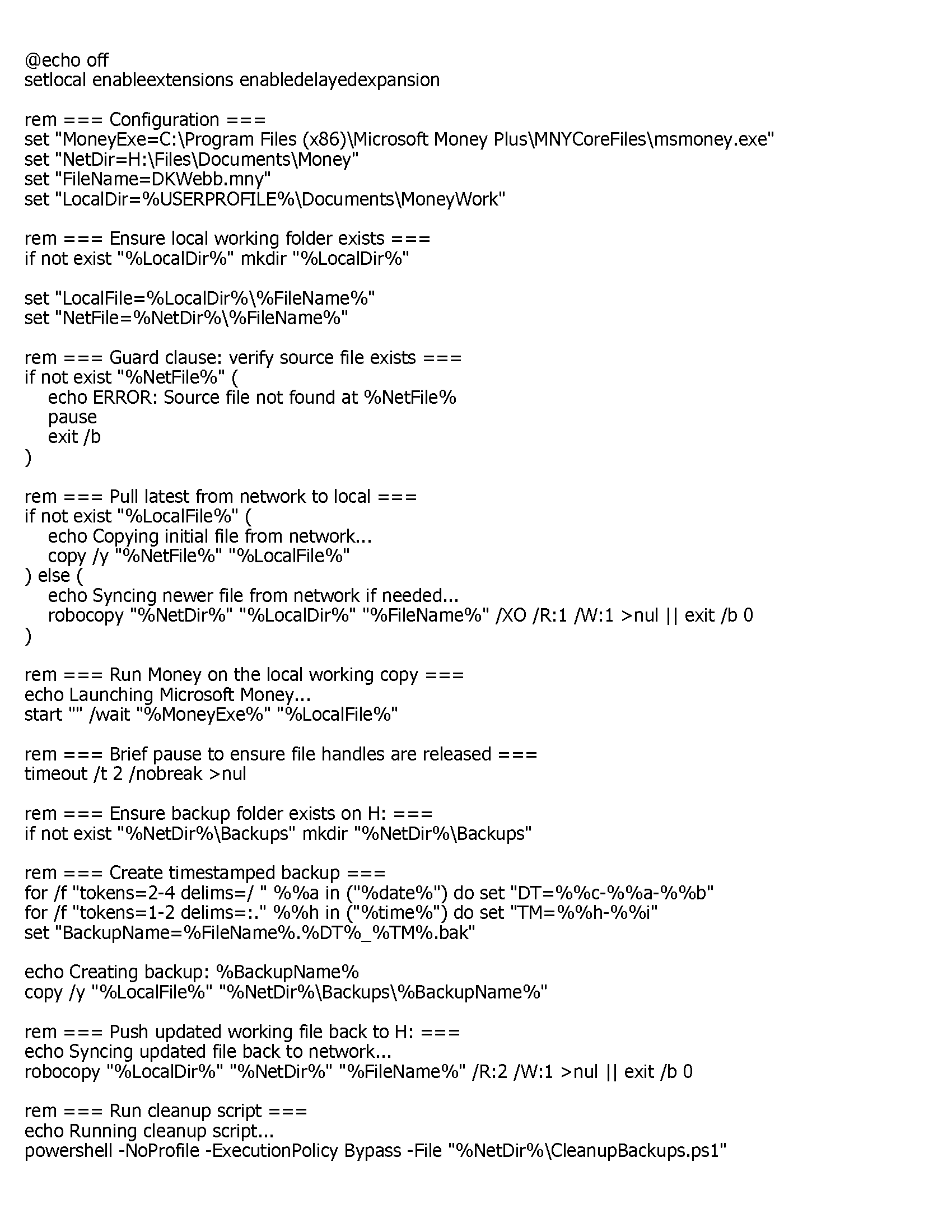

Could someone look at the attached script and see if there is something in it that isn't correct and would cause this?

    You've got a .bat file that copies the data files to your local drive, runs Money, and then copies them back. There does not appear to be anything functionally wrong with what it does.
    I don't know why you did it that way. I would have just left my data files on my C:\ drive and used the NAS strictly for backup. That way you have your data on 2 different devices and if one of them malfunctions, you still have another copy of the data.
