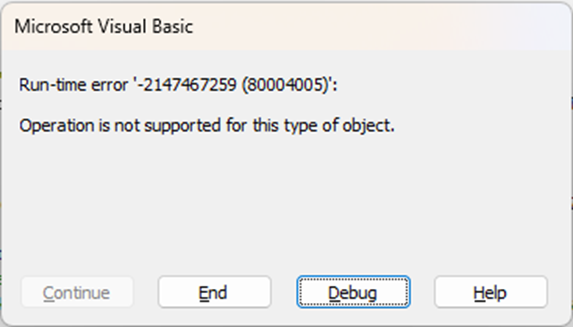

Today, I don't know why, I'm getting the below error screen:
Any idea on solving this issue?

    The error you're encountering, Runtime error '-2147467259 (80004005)' operation not supported for this type of object, often happens when there's an issue with the database provider or the operation you're trying to perform. In your case, this can happen when working with MS Access .accdb files via VBA and ADODB, especially if something changed in the environment or Access itself.
