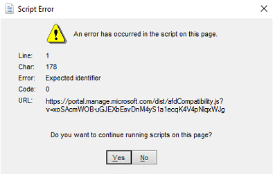

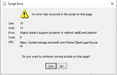

I'm trying to install the Intune Certificate Connector and am running into script errors on a Windows Server 2022 machine.
Things I have tried:
  • Adding *.microsoft.com and *.microsoftonline.com to the trusted sites
  • Adjusted browser security settings to low to allow active scripting and javascript
  • Ensured TLS 1.2 is enabled in the system through registry
  • Disabled Compatibility view through local GPO and in Edge settings
  • Cleared browser cache
I've also checked the pre-requisites for the connector and they all seem to be set up correctly.
Would like some assistance with this one please.

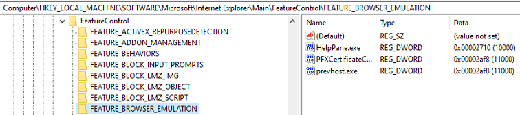

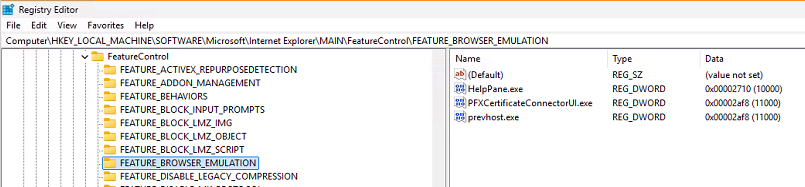

    I was able to work out the issue with some help and resolve it by adding some registry keys to allow the configuration app to function using Internet Explorer even though it should be using the Webview2 modules.
    In location:
    Computer\HKEY_LOCAL_MACHINE\SOFTWARE\Microsoft\Internet Explorer\Main\FeatureControl\FEATURE_BROWSER_EMULATION
    Add DWORD (32-bit) value:
    PFXCertificateConnector.exe with decimal value 11000
    Update prevhost.exe decimal value to 11000

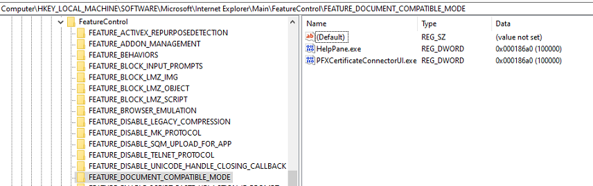

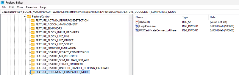

    In location:
    Computer\HKEY_LOCAL_MACHINE\SOFTWARE\Microsoft\Internet Explorer\Main\FeatureControl\FEATURE_DOCUMENT_COMPATIBLE_MODE
    Add DWORD (32-bit)
    PFXCertificateConnector.exe with decimal value 10000 (11000 should work as well but we didn't test this)
    Hope this can help someone else experiencing the same issue.
    Browser Emulation
    Document Compatible Mode

      • If Edge/Chromium is missing or restricted, the connector may fall back to legacy components that do not fully support the portal scripts, resulting in errors such as missing addEventListener or “Expected identifier”.
