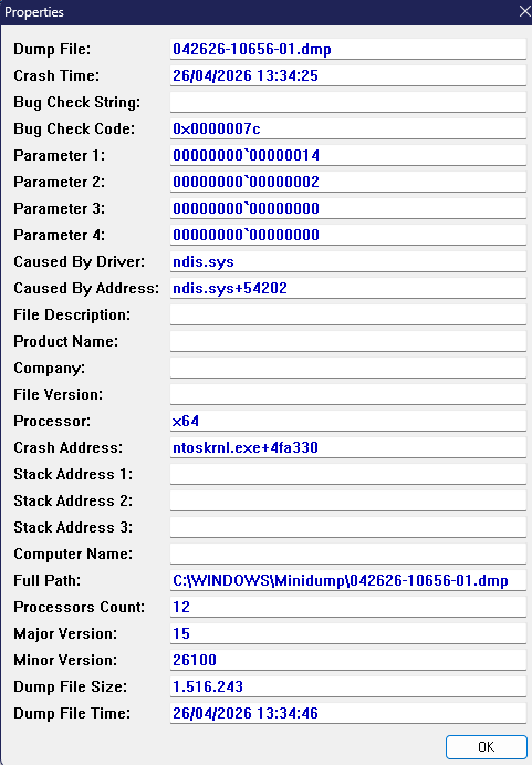

Random BSOD. ndis.sys
Johan Nathan 20 Reputation points
2026-04-26T06:43:14.5833333+00:00
The driver \Driver\WUDFRd failed to load.
Device: USB\VID_2808&PID_A99A\1234567890ABCDEF
Status: 0xC0000365
All drivers and windows update are up to date.
Please help

Your data indicates two separate problems which are most likely unrelated.
1
The Device ID you list (USB\VID_2808&PID_A99A\1234567890ABCDEF) resolves to a FocalTech Fingerprint reader driver, do you have that type of device on your system?
2
For the system crashes, please check to see if your PC is producing any minidump files, I will check those to see if they provide any insight into a potential cause of the system crashes.

  1. AI answer
    2026-04-26T06:43:33.93+00:00
    The crash dump shows a bug check in ndis.sys, which is the Windows network driver framework used by miniport/network drivers. BSODs involving ndis.sys are commonly caused by faulty or incompatible network adapter drivers or by issues fixed in Windows updates that include an updated ndis.sys.
    For similar issues on supported Windows versions, Microsoft has provided fixes that update ndis.sys to newer builds to address stop errors and power‑state failures involving network drivers. In those cases, the resolution is to install the corresponding Windows update or hotfix that contains the updated ndis.sys file.
    Given that the dump points to ndis.sys and there is also a WUDFRd (user‑mode driver framework reflector) load failure for a USB device, the recommended approach is:
    1. Ensure the system has all current cumulative and driver updates installed, especially those that update ndis.sys.
    2. Update or reinstall the network adapter drivers (Wi‑Fi and Ethernet) from the system or adapter manufacturer so they are built and tested for the current Windows 11 build.
    3. If BSODs continue, check for vendor guidance or firmware/driver updates for any Wi‑Fi or network‑related hardware, as similar ndis.sys stop errors have been confirmed and fixed via updated drivers/Windows updates on earlier Windows versions.
    If, after updating Windows and all network/USB‑related drivers from the hardware manufacturer, the issue persists, contact the device or PC manufacturer with the minidump for further analysis, as they may need to provide an updated miniport or USB driver.
