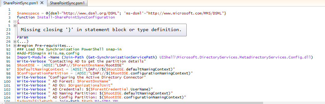

Microsoft Identity Manager Synchronization Service is updated from 4.4.1302.0 to 4.6.263.0 (August 2020 Version) and SharePoint Connector is updated from 4.3.2430.0 to 4.4.1800.1 for SharePoint 2016. However the SharePoint Sync Powershell gives the below error. Please share the latest working SharePointSync Files

    When I try to execute the powershell, getting the following error

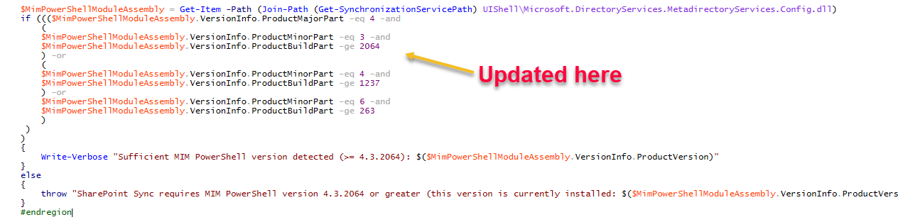

    Fixed the above error by updating the code as shown below.
    The script is working fine. Thanks Trevor for your usual support. Please let us know anything else required.
