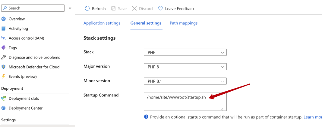

    You have mistake in your steps u need next
    1. open for edit startup.sh (can do it on console) (this file) User's image
    and add to this file next (for php8.1)
    apt-get update && apt-get install -y libfreetype6-dev \
                    libjpeg62-turbo-dev \
                    libpng-dev \
                    libwebp-dev \
            && docker-php-ext-configure gd --with-freetype --with-webp  --with-jpeg
    docker-php-ext-install gd

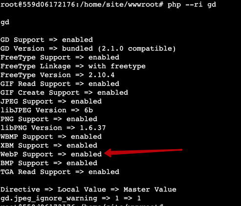

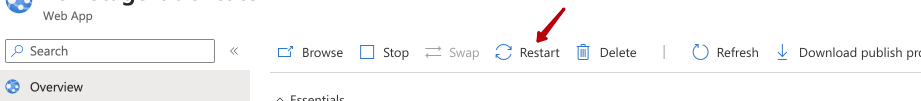

    1. restart u azure web app
    and after restart, go to console and run command php --ri gd and u can look this User's image
    after this u must be happy )
