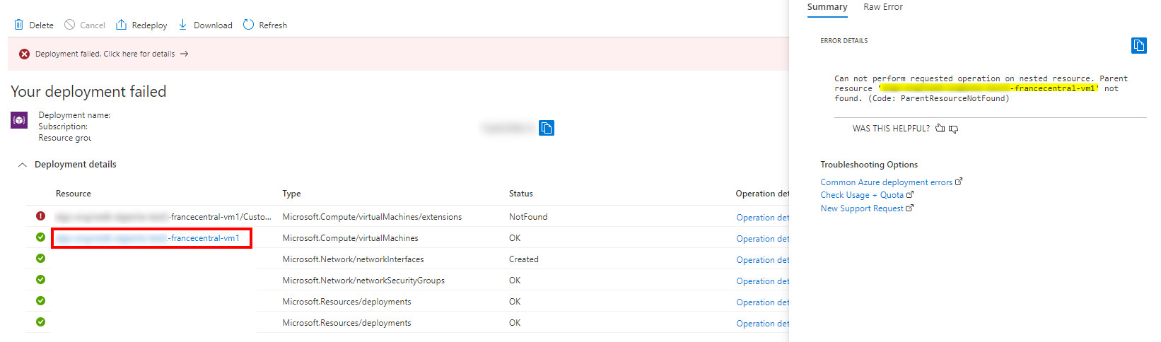

I am using ARM template. I added dependsOn to the extensions but sometimes It throws error that Parent resource VM not found.
Despite that the VM is already created.
Weird thing that sometimes I run it successfully, sometimes it run into error. Maybe it comes from the instability of Azure network itself?
Can someone help me to explain this? or any way to fix it?
I don't want to get this error anymore.
My code (shortened):
"resources": [
              "type": "Microsoft.Compute/virtualMachines/extensions",
              "name": "[concat(variables('vmNamePrefix'), copyIndex(1), '/CustomScript')]",
              "apiVersion": "2020-12-01",
              "location": "[parameters('location')]",
              "dependsOn": [
                "[resourceId('Microsoft.Compute/virtualMachines', concat(variables('vmNamePrefix'), copyIndex(1)))]"
              "properties": {
                "publisher": "Microsoft.Azure.Extensions",
                "type": "CustomScript",
                "typeHandlerVersion": "2.1",
                "autoUpgradeMinorVersion": true,
                "settings": {
                  "fileUris": [...],
                  "skipDos2Unix": false,
                  "timestamp": 123456789,
                  "commandToExecute": "[concat('sh ', variables('vmPostScript'))]"
