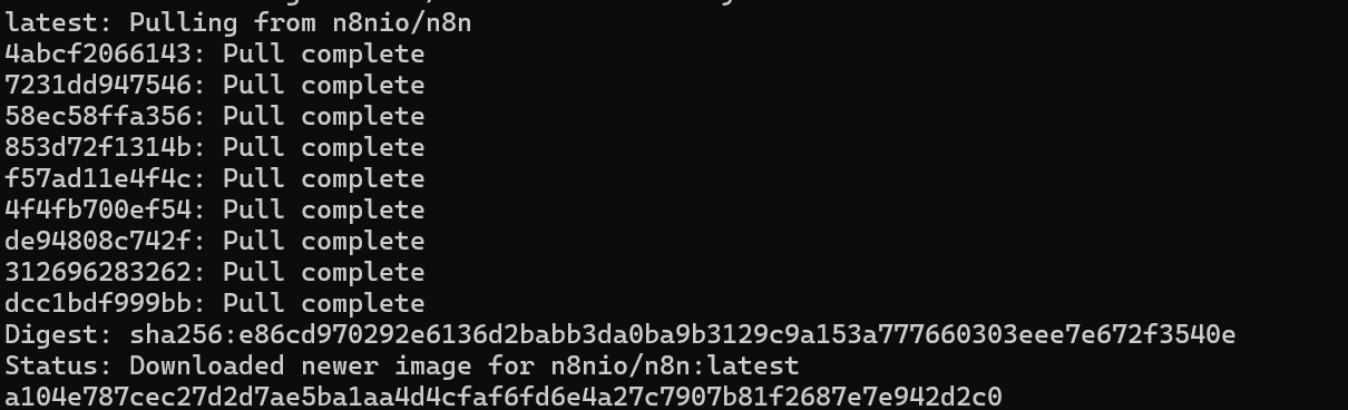

    Installing docker with below commands:
    • sudo apt update
    • sudo snap install docker
    Starting n8n in Docker
    • *sudo docker run -d --restart unless-stopped -it *
      *--name n8n \*
      *-p 5678:5678 \*
      *-e N8N_HOST="your-domain.com" \*
      *-e VUE_APP_URL_BASE_API="https://your-domain.com/" \*
      *-e WEBHOOK_TUNNEL_URL="https://your-domain.com/" \*
      *-v ~/.n8n:/root/.n8n \*
      *n8nio/n8n*
    Please replace your-domain.com with your actual domain. After this, you can access n8n on your-domain.com:5678

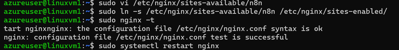

    After that, you can create a symbolic link of this file in the sites-enabled directory:
    • sudo ln -s /etc/nginx/sites-available/n8n /etc/nginx/sites-enabled/
    Run below commands:
    • sudo nginx -t
    • sudo systemctl restart nginx

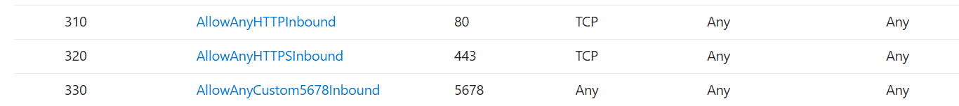

    You would also need to allow ports 80, 443 (for HTTPS), and 5678 (for n8n) in your NSG.
    At this point, you should be able to access n8n on your-domain.com
    Please ensure that DNS records are added for the domain to correctly point to the IP address, including both A (IPv4 address) and AAAA (IPv6 address) records for the domain "your-domain.com" within the DNS (Domain Name System).
