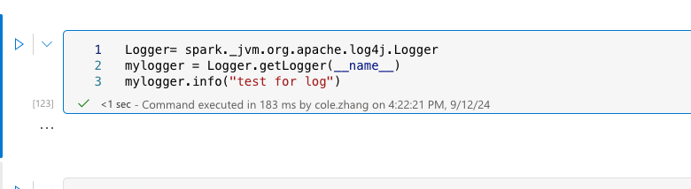

May I know in Synapse pyspark notebook, how can we write log to stderr, and also shows it in the cell output?

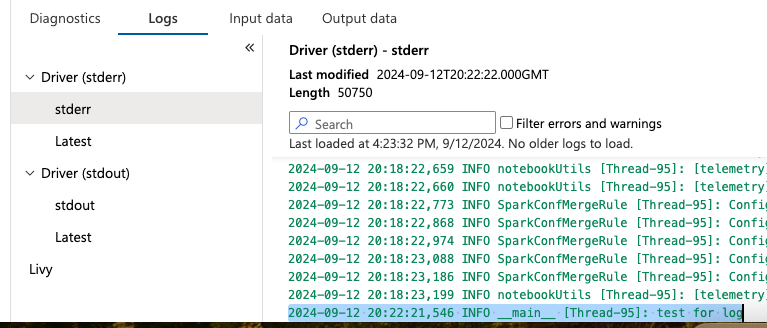

I try to write the log with log4j, log will goes to stderr log, but will not shows in cell output

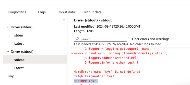

But if we try with different log ways like: logging.getLogger, sys.stderr.write('log test'), print("test log", file=sys.stderr), etc.
Log will shows in cell ouput, and in stdout, but will not goes to stderr.
May I know is there anyway log can goes to stderr and also shows in cell output? Thanks so much!
