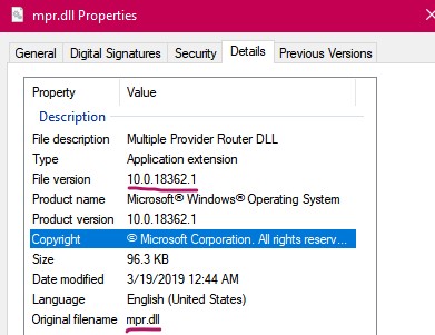

    You are welcome. Good that it appears not to be a virus. I'm looking around for more ideas now. If nothing at all good is found, maybe I'll pass you my own MPR.dll to try through OneDrive...
    That's the 1909 version, & it belongs in C:\Windows\System32. But I still don't like the sound of "program.exe". That appears to be what wants to use MPR.dll -- but Program.exe is not part of a normal Windows installation.

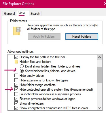

    Where is Program.exe located? What is in the Details tab of its Properties? In "Folder Options, View tab" (type into Search bar), ensure "Show hidden files..." is selected, & even uncheck "Hide protected...". Then look for it in File Explorer.
