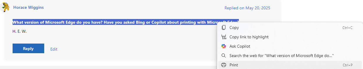

    2025-05-20T19:29:26+00:00
    What version of Microsoft Edge do you have? Have you asked Bing or Copilot about printing with Microsoft Edge?
    I have this version.
    I just selected and printed this without any problems.
