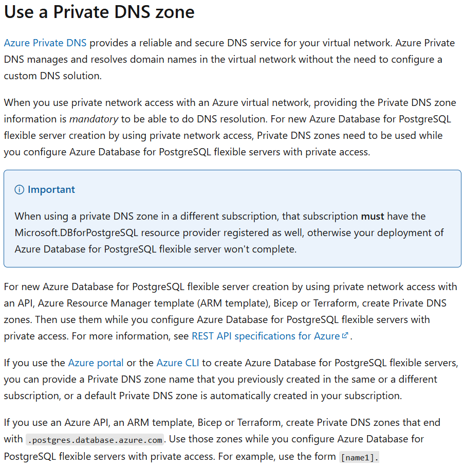

    When you deploy PostgreSQL Flexible Server in VNet injection mode, Azure doesn’t automatically register its hostname in your private DNS unless you’re using the built‑in Azure DNS or you’ve linked the Azure provided Private DNS zone for PostgreSQL. If you point your Logic App at that VNet but your DNS can’t resolve the server’s *.postgres.database.azure.com name, you’ll get exactly “No such host is known.”
    From a VM in the same VNet/subnet setup exactly as your Logic App host, run:
    nslookup yourserver.postgres.database.azure.com
    You should see the private IP of your Flexible Server. Once your DNS is correctly resolving the yourserver.postgres.database.azure.com name to the private IP, your Logic App will be able to open the connection; however, if this fails, you will need to create Private DNS zones.
    Find Use a Private DNS zone
