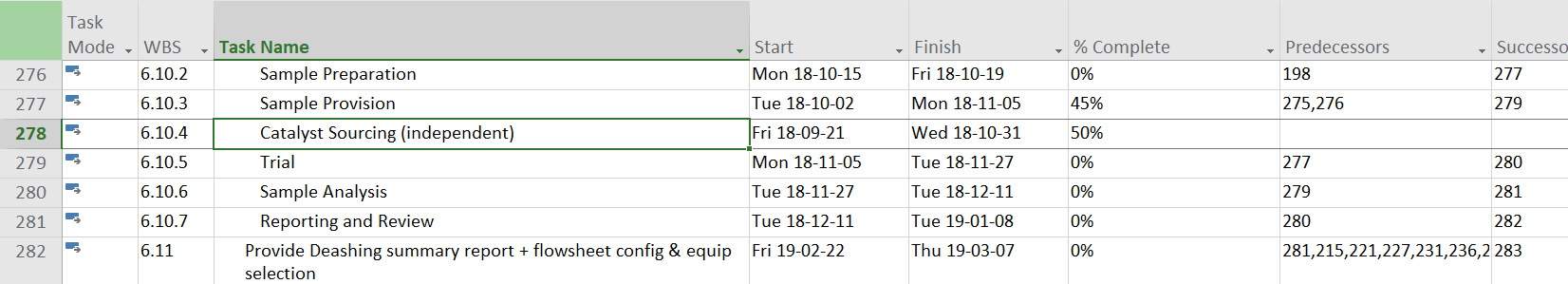

I'm working on a complex project (500-line items) and I think there is an error on the Total Slack calculation and the critical path. I am NOT using sub-project. It's all in one plan.
There's 5 specialty teams. 4 out of the 5 teams are trying to achieve one milestone; the other (let's call it "Oddball team") is on their own for the most part where their completion date is irrelevant to the major milestone. For the "Odd ball" team's plan, it is completely independent of these other teams plans (no cross dependencies).
Oddball team's plan is scheduled to finish end of April 2019. The major milestone everyone else is scheduled for is Oct 2019. Yet, I have a task from Oddball's team that is "critical" even though it's not connected to any of the other critical tasks! It shouldn't be critical because it's scheduled to finish way before Oct 2019.

Another issue is that one of my tasks is late. It is now turned on to the critical path (which is fine). This task has a few successors that are now showing late too. Do you know why these other successor tasks aren't turning red and on critical path too?

OK. By "FS0" I mean finish - start with zero lag. Your critical path method will never work properly unless you have a "closed" network. If you google search for critical path network you will find hundreds of pictures of closed networks, where every task is on a path from the first task to the last task. It is always useful (I would say mandatory) to have a start milestone and a finish milestone, each with zero duration, and these should be the only tasks/milestones which do not have both an FS0 predecessor and a FS0 successor. So the FS0 predecessor of your 278 should be the start milestone, and the FS0 successor should be the finish milestone. You want no blank predecessors and no blank successors.

The heading of your question is "Slack Calculation Error," but you've provided no data to assist in answering the question.  I.e. for specific tasks, what are the predecessors, successors, early dates, late dates, actual dates, and Slack (Start, Finish, Free, Total).
Based on the extremely limited information available, I'd suspect an issue related to out-of-sequence progress.  (Task 277 started and completed 45% even though its predecessor Task 276 has not even started.  There are likely others.)  Such out-of-sequence progress throws a wrench into the backward-pass calculations.  (It's provided the only example I've ever observed where Total Slack was NOT based on the late dates.)  Unfortunately, the more recent versions (e.g. 2016, 365) of Project are less tolerant of out-of-sequence progress, resulting in a lot of incorrect zero-slack calculations.  I'd suggest that you fix the logic such that no out of sequence progress is reported.

    • Not sure what you mean by FS0 predecessor. But not all tasks have predecessors or successors (most do, but there are a few that don't). See 6.10.4 as an example. The ones that I think are incorrectly on critical path DO have predecessors and successors
    • I made sure not to put any predecessors or successors at the summary task level
    • I do not have "show multiple critical paths" checked.
    The task is late relative to the Finish Date / Baseline. For 6.10.3 it was supposed to be completed November 5th but now it's November 21st. This should in theory, be kicking out the rest of the dates if I were to change the Finish Date to say December 1st. If I were to do that, Sample Provision (6.10.3) is still the only task that is highlighted on the critical path, even though it's (directly or indirectly) linked to 6.10.5 and 6.10.6.
