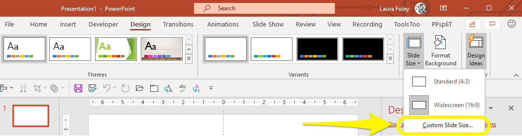

    2020-02-15T18:00:41+00:00
    It's hard to tell exactly from the screenshot, but it *appears* as though the image is printing borderless on two sides but with border on the other two sides.  That suggests that the slide size is not proportional to the size of the page you're printing on.  PowerPoint won't distort your slides to make them fit on page sizes that don't match the slide proportions.
    That makes sense, since even when you set "Slide sized for" as Letter Paper (8.5x11 in), the dimension of the page is 7.5x10 in. You could try setting the page size as 8.5x11 and see if that helps.
    Select Custom Slide Size in the Design tab:
    Entering the correct width and height:
