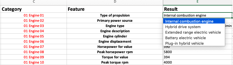

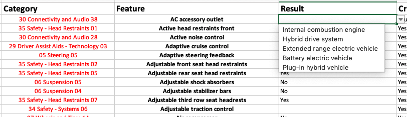

    I tried right clicking in Column A. It sorts, but just that column (there are gaps, so not a good example).  So I tried right clicking in Column B, and sorting A-Z loses all of the pull down references as before.  I also tried selecting all of the columns, and the issue persists. Here's a screen shot before the sort:
    And after:
    What I'm after is the pull down menu to 'travel' on a sort with the feature, so that "Type of propulsion" pull down will stay with "Type of propulsion". As you see from the second screen grab, it stays where it was and is now associated with "AC accessory outlet"
    The sheet sorts just fine. It's the pull downs that don't move with the sort is the problem.
