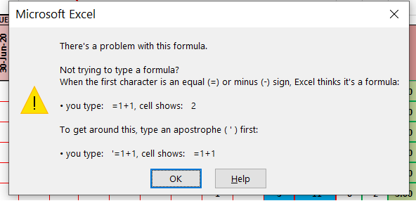

I chose to use the Method rather than the Function because it seemed to offer more control over the input, however it produced problems.
1 my first attempt did not include a Default parameter. The response to a null entry produced the error msg below. As I have secified Type=1 this seems odd.
2 I got rid of it by introducing Default=0. However if the 0 is accepted my code exits under Case False despite the fact that the var lnWinsDue =0.
3 The input box shows a "?" in the header. When selected this launches a web page on "Select a range to import to Visio". Very interesting but irrelevant. I tried using the HelpFile parameter with enties like HelpFile:-"" but got the same result.
Other that that it seems to work when normal inputs are used. Trouble is that users don't behave that way.

    I am using macros in Excel 365 Home. I need the user to input a number. On previous occassions I had used the InputBox Function which worked well with strings. Recently I discovered the Application.InputBox method and noted it could specify the input data type. It does work and rejects any non-numeric entries. However it brings other complications. I want to prevent any unsceduled events. The input should cope with whatever the user throws at it, such as an "Enter" without any value (eqivalent to a blank string) in the Box, entering 0 or any other unwanted number. I though my code covered that but the results are not as expected. The Cancel button returns False as expected. But 0 is also detected as False despite the var lnWinsDue holding 0. OK as long as 0 is not an acceptable input but certainly not what one would expect. I found out about 0 because a null entry initiated the message box I pasted to my initial post. I found that specifying a default value prevented that unwanted intrusion. My other issue is the "?" that appears in the inputbox header. As described it initiates the web browser and I cannot find a way of stopping it..
    It seems that this Method is a bit cranky but I had hoped someone had travelled this road before me. If I am forced to go back to the standard input box I will have to write code to ensure I get only numeric values input. Messy!
    Hope this clarifies my problem
