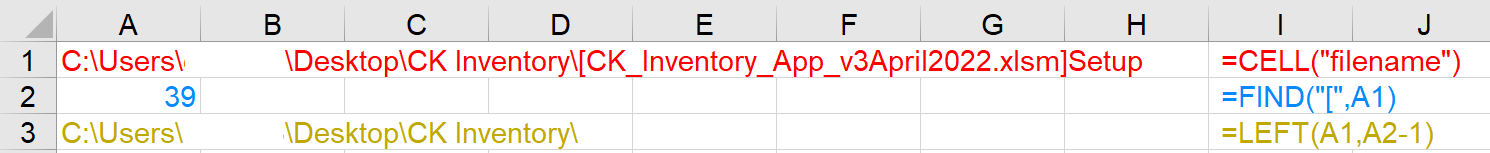

    Thank you for the link. I was able to create the relative path using this method. The following information is for anyone that may run into the same issues I did.
    I kept getting an error using that formula so I split it into three steps and named cell A3 "filepath." Column I shows what is written in Column A.
    Then I followed the instructions from the link, which added one line (line 2) to my code and made some adjustments to the Source line.
    My old code did not contain line 2 and the source line looked like the following:
    Source = Excel.Workbook(File.Contents("C:\Users\***\Desktop\CK Inventory\ckoperations.xlsx"), null, true),
    One problem I encountered was missing a comma at the end of line 2.
    Also, this solution did not work when I had the file saved to OneDrive. It had to be on the physical computer.
