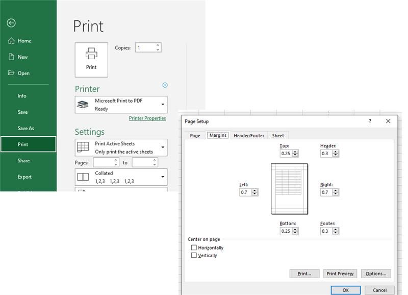

    If my understanding is right, for the situation you encountered, we do understand the inconvenience caused and apologize for it. And I just tested from my side and here is my test screenshot view for your reference:
    By default, printer is set to "Microsoft print to PDF", if possible, could you please try to set something else as the default printer and check if there is any difference.
    What you're running into is probably a limitation imposed by the printer. Most printers have minimum margin requirements.
    If you can't override the printer in Excel's Page Setup options or by using the settings in the Print dialog, try generating a PDF. You may then be able to get the PDF printed effectively.
