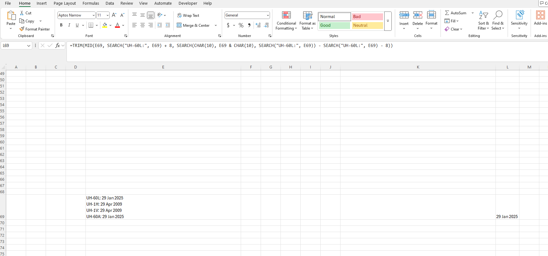

2025-02-03T19:02:08+00:00
Hi Andrew Buck2,
Thanks for your valuable feedback and sharing updates with us and I really appreciate your effort and your precious time doing.
And I appreciate your kind words.
If the data in cell E69 contains line breaks:
=TRIM(MID(E69, SEARCH("UH-60L:", E69) + 8, SEARCH(CHAR(10), E69 & CHAR(10), SEARCH("UH-60L:", E69)) - SEARCH("UH-60L:", E69) - 8))
Or if you please send copy of your document file to me so that I can look from my side, and I will check this behavior and help you to fix and verify the result with you.
If there is confidential information, then you can send it to me in Private Message(PM). you can access PM from the top right corner of this page, as shown in image below:
Your understanding and patience will be highly appreciated. I hope that you are keeping safe and well!

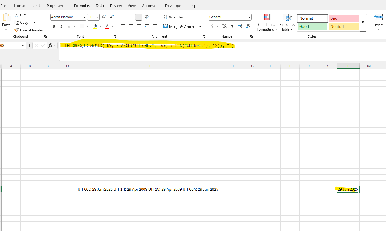

2025-02-03T18:27:57+00:00
Dear respected  Andrew Buck2,
Good day! Thank you for posting to Microsoft Community. We are happy to help you.
As per your description,
=IFERROR(TRIM(MID(E69, SEARCH("UH-60L:", E69) + LEN("UH-60L:"), 12)), "")
If there is any misunderstanding, I apologize and please feel free to post back to us with more detailed information for better understanding and guiding you further.
Please understand that our initial reply may not always immediately resolve the issue. However, with your help and more detailed information, we can work together to find a solution.
I'm sorry and I apologize for that.
Appreciate your patience and understanding and thank you for your time and cooperation.
Sincerely,
Waqas Muhammad
