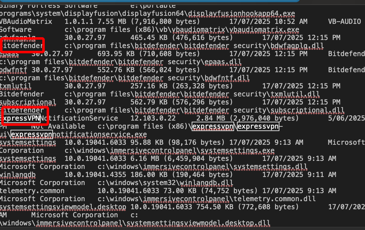

    After reviewing both the minidump debugger output and your system information, I’ve diagnosed the crash as a KERNEL_SECURITY_CHECK_FAILURE with bugcheck code 0x139.
    The first parameter of 0x3 points to LIST_ENTRY_CORRUPTION, meaning a critical data structure inside the Windows kernel was compromised—most commonly due to a third-party driver writing beyond its allocated memory buffer and unintentionally overwriting other areas of memory.
    Based on your system’s configuration and the nature of the crash, the most likely contributors are the multiple network and security-related filter drivers in use simultaneously:
    1. Bitdefender: Antivirus and firewall drivers (bd... drivers in your list) hook deep into the kernel and network stack.
    2. ExpressVPN: This installs its own network drivers (tapexpressvpn.sys, expressvpntun.sys) to route traffic.
    3. simplewall: This is another firewall/network filtering application.
    4. VB-Audio Matrix VAIO: Virtual audio drivers, while less common, can also cause kernel instability.
    5. User's image
    Having multiple drivers trying to filter and control the same network traffic is a classic recipe for this type of memory corruption and system instability.

    1. Your BIOS version is 2202 from July 2020. There have been numerous critical AGESA updates released by AMD since then that significantly improve system stability, memory compatibility, and I/O performance. This is the single most important step you can take.
    2. After updating the BIOS and chipset drivers, you must systematically remove the conflicting filter drivers to find the culprit. Disabling is not enough; they must be fully uninstalled.
      1. Fully uninstall simplewall
      2. Fully uninstall ExpressVPN
      3. Use the official Bitdefender Uninstall Tool to ensure all kernel drivers are removed. You can download it from the Bitdefender support site.
      4. Once the above drivers are removed, reboot your system and run it with just Windows Defender active for protection.
    I hope this information helpful
