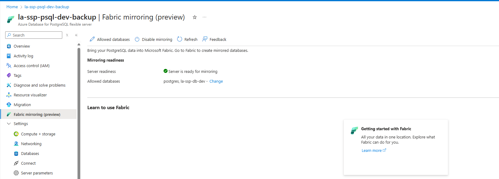

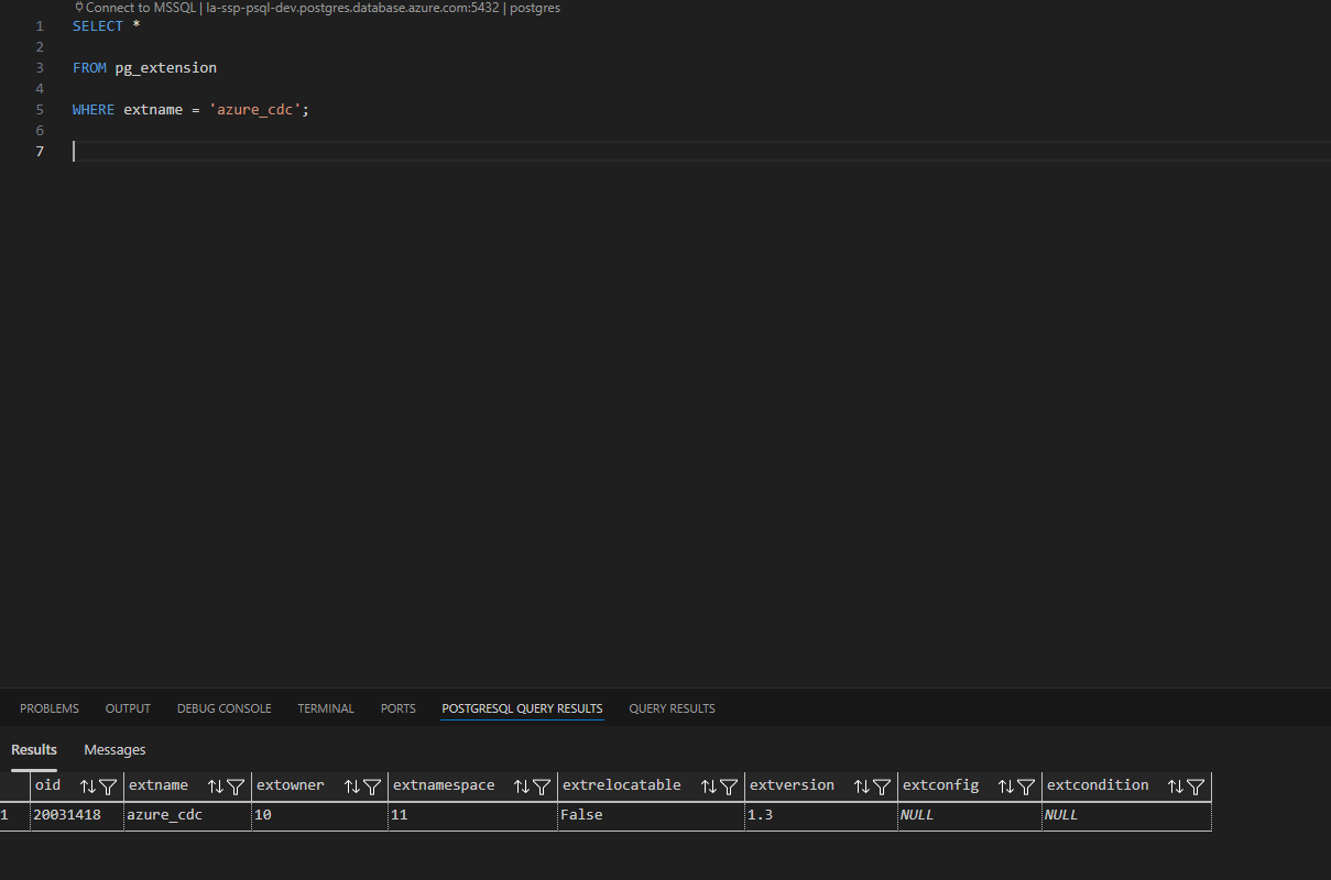

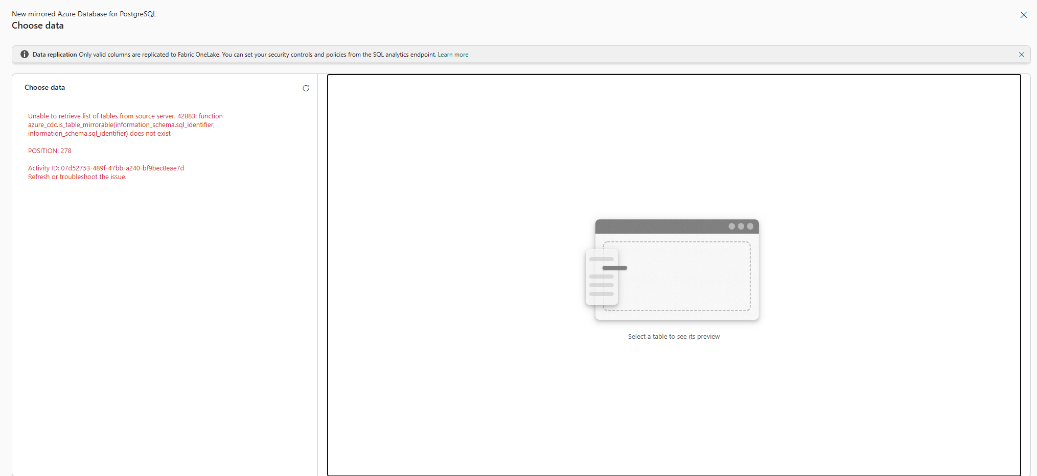

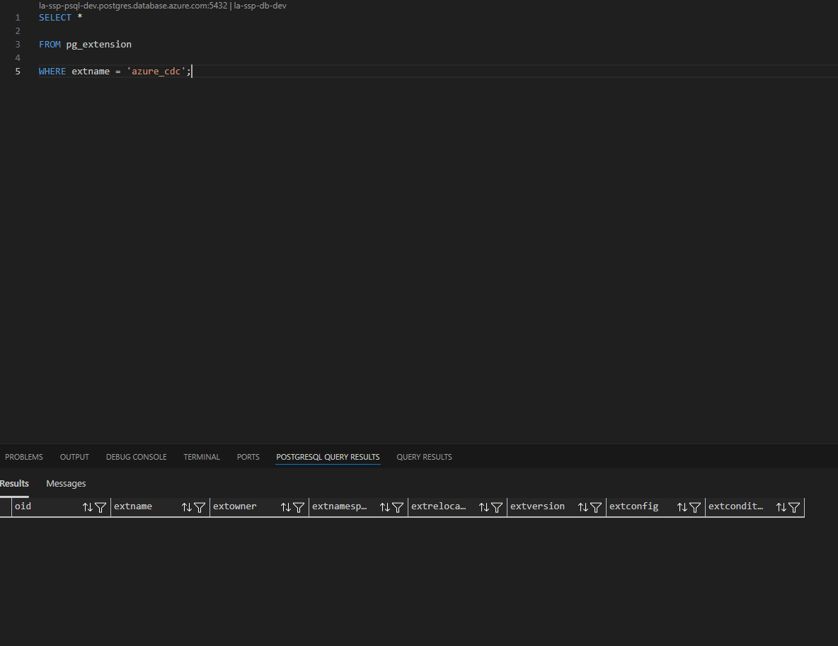

Mirroring on the postgresql db does not install cdc extension which does not allow mirroring to be enabled
in default db named postgres it isntalls but in our other db it does not. Anyone have an idea why it can be like this ? We using the preview function and doing everythign what it says in microsoft learn

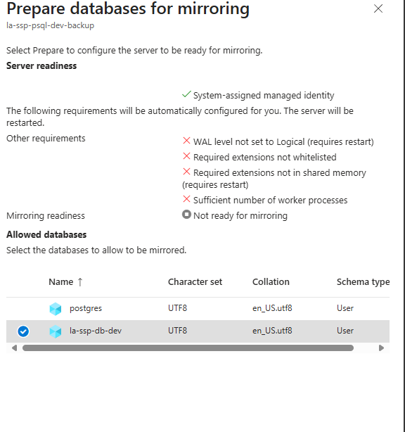

    Server parameters was like this:
    wal_level → set to logical
    • azure.extensionspg_stat_statements is enabled. azure_cdc is not available to set, as we understand it should normally be installed during the preparation wizard. A manual installation attempt caused server errors and prevented connections, so a rollback was required.
    • shared_preload_libraries → set to pg_stat_statements, azure_cdc is not availiable as its not installed
    max_worker_processes → set to 16

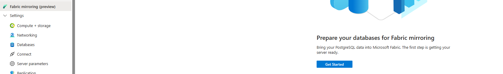

    You can rerun the mirroring enablement flow and include the right DB
    In the Azure portal, go to your Azure Database for PostgreSQL Flexible Server under Fabric mirroring (preview) then Get started:
    • The page checks prerequisites and lets you select which databases to enable.
    • Select your user DB (not just postgres) then click prepare then accept the restart.
    This flow preloads and registers azure_cdc only for the selected databases and bumps needed server params. https://learn.microsoft.com/en-us/azure/postgresql/flexible-server/concepts-fabric-mirroring

    You can check if the extension is registered in that specific database:
    -- Is the extension even available on the server?
    SELECT * FROM pg_available_extensions WHERE name = 'azure_cdc';
    -- Is it installed in THIS database?
    SELECT * FROM pg_extension WHERE extname = 'azure_cdc';
    -- Did the workflow set logical WAL?
    SHOW wal_level;
    If pg_extension returns no row for azure_cdc in your DB, it wasn’t registered there then go back to step 2.
