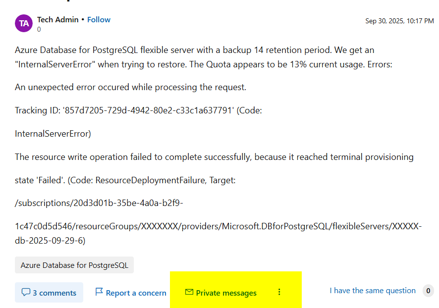

Azure Database for PostgreSQL flexible server with a backup 14 retention period. We get an "InternalServerError" when trying to restore. The Quota appears to be 13% current usage. Errors:
An unexpected error occured while processing the request.
Tracking ID: '857d7205-729d-4942-80e2-c33c1a637791' (Code:
InternalServerError)
The resource write operation failed to complete successfully, because it reached terminal provisioning
state 'Failed'. (Code: ResourceDeploymentFailure, Target:
/subscriptions/xxxxxxxxx/resourceGroups/XXXXXXX/providers/Microsoft.DBforPostgreSQL/flexibleServers/XXXXX-db-2025-09-29-6)

  1. Tech Admin 0 Reputation points
    2025-10-03T20:17:14.82+00:00
    Turns out the restore worked fine by changing the 'availability zone' in the server details (FYI - if someone else sees the same issue).
