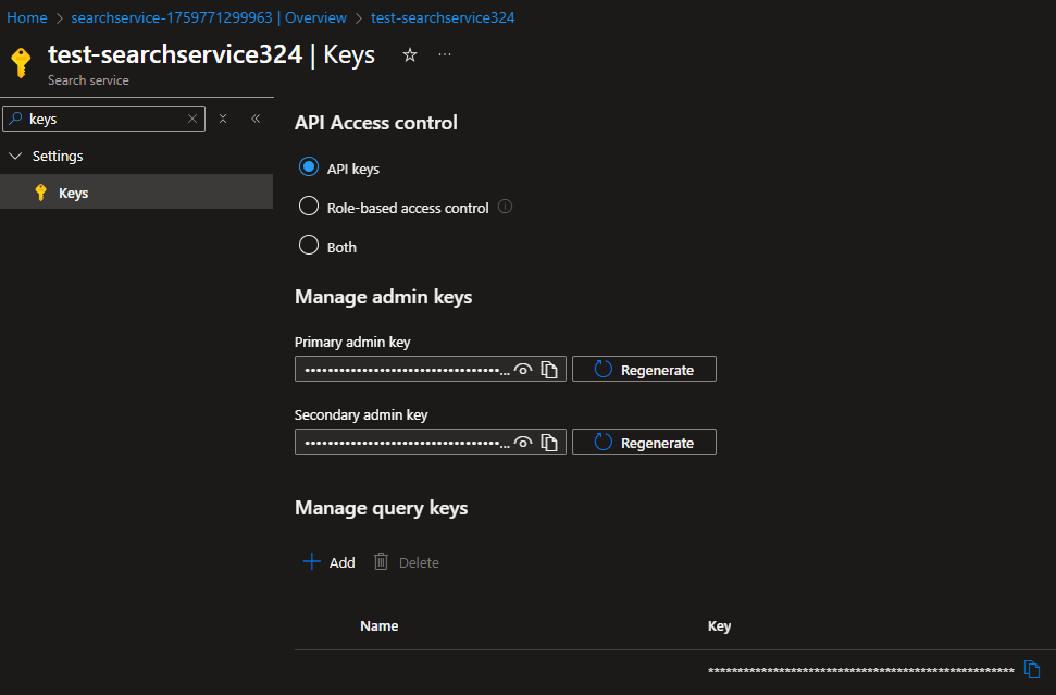

    If the network settings are correct, the next step is to ensure you're using the correct key. The screenshot provided by Moritz shows you exactly where to look. Your chatbot needs a powerful Admin Key, not a limited Query Key.
    1. In your Azure AI Search resource, navigate to the Keys blade on the left menu, just as shown in the screenshot.
    2. You will see two Admin Keys (Primary and Secondary). A common mistake that causes a 403 error is accidentally using a Query Key, which doesn't have enough permission for this task.
    3. Copy one of the full Admin Keys.
    4. Go back to your Azure OpenAI Studio where you configured the chatbot's data source. Edit the connection and paste this Admin Key into the authentication field.

    Sounds like your chatbot is hitting Azure AI Search but getting blocked when it tries to read the index schema. That happens if you’re using a query key (which can only run searches) instead of an admin key, or if your managed identity doesn’t have the right RBAC role.
    • With keys: switch to the Admin key.
    • With managed identity: give it Search Service Reader or Contributor on the Search resource, and make sure Search allows public access or "trusted services".
