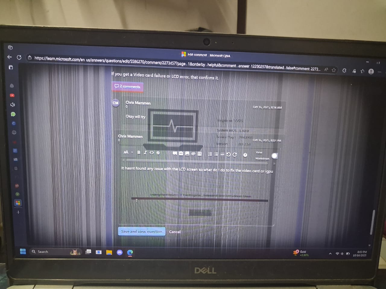

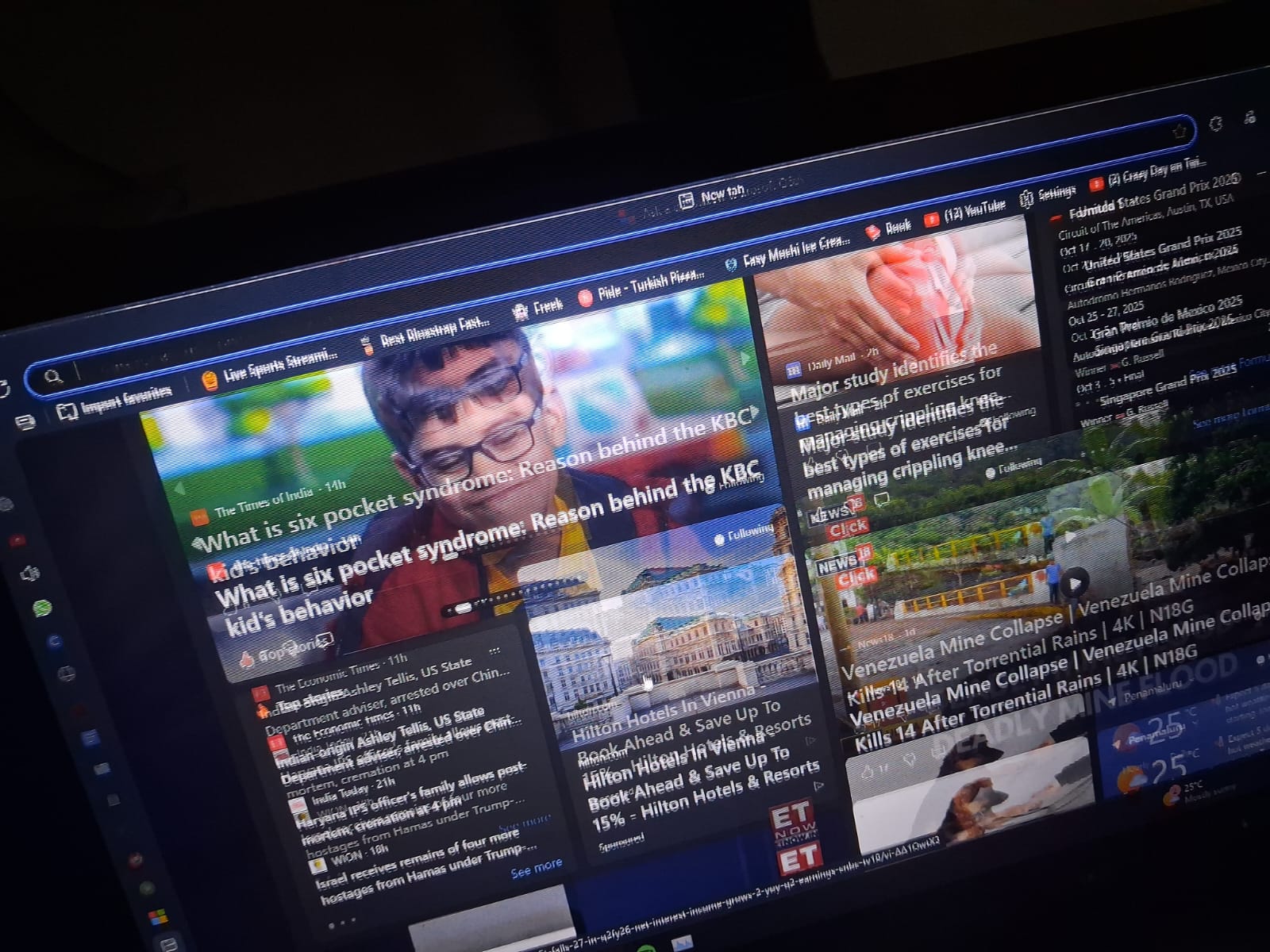

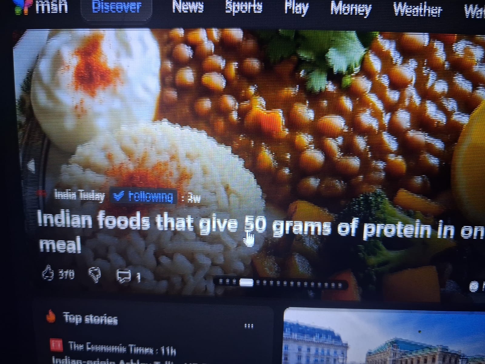

I dont why and how it started but after a 15mins of using it started gliching like this not sure why it doing this and i tried restarting and doesnt work. Can someone explain how to fix this werid glich?User's image
User's imageDell Laptop Inspiron 5593:

  1. Ferdinand Nanalig 29,980 Reputation points Independent Advisor
    2025-10-16T02:21:44.3333333+00:00
    Please test with an external monitor
    Connect your laptop via HDMI to a TV or external display.
    Then boot into BIOS again.
    If the external screen looks normal, your laptop LCD panel or cable is at fault.
    If the glitch appears on both screens, the iGPU (inside CPU) is likely failing.
    Run a hardware test after.
    Dell has a built-in hardware test:
    Power off your laptop.
    Hold Fn, then press Power.
    Wait for the Dell ePSA diagnostics to start.
    Watch for video tests — if you see artifacting or flashing, note any error codes.
    If you get a Video card failure or LCD error, that confirms it.
