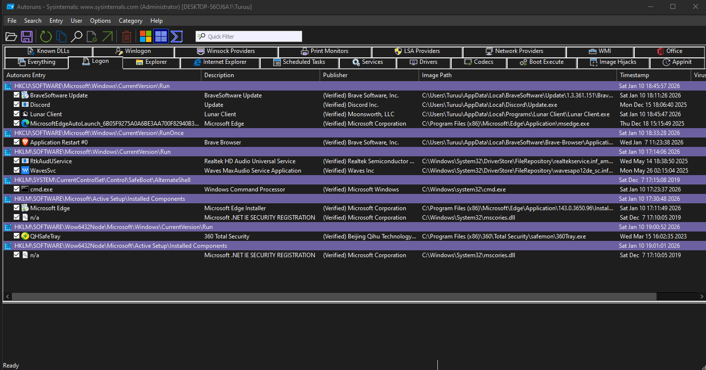

    Click the link below to download a small free utility that does not require installation.
    https://download.sysinternals.com/files/Autoruns.zip
    When the file downloads, unzip it.
    Run Autoruns64 as Administrator
    1
    Select the 'Logon' tab at the top of Autoruns.
    Please provide a screenshot of all entries on that tab.

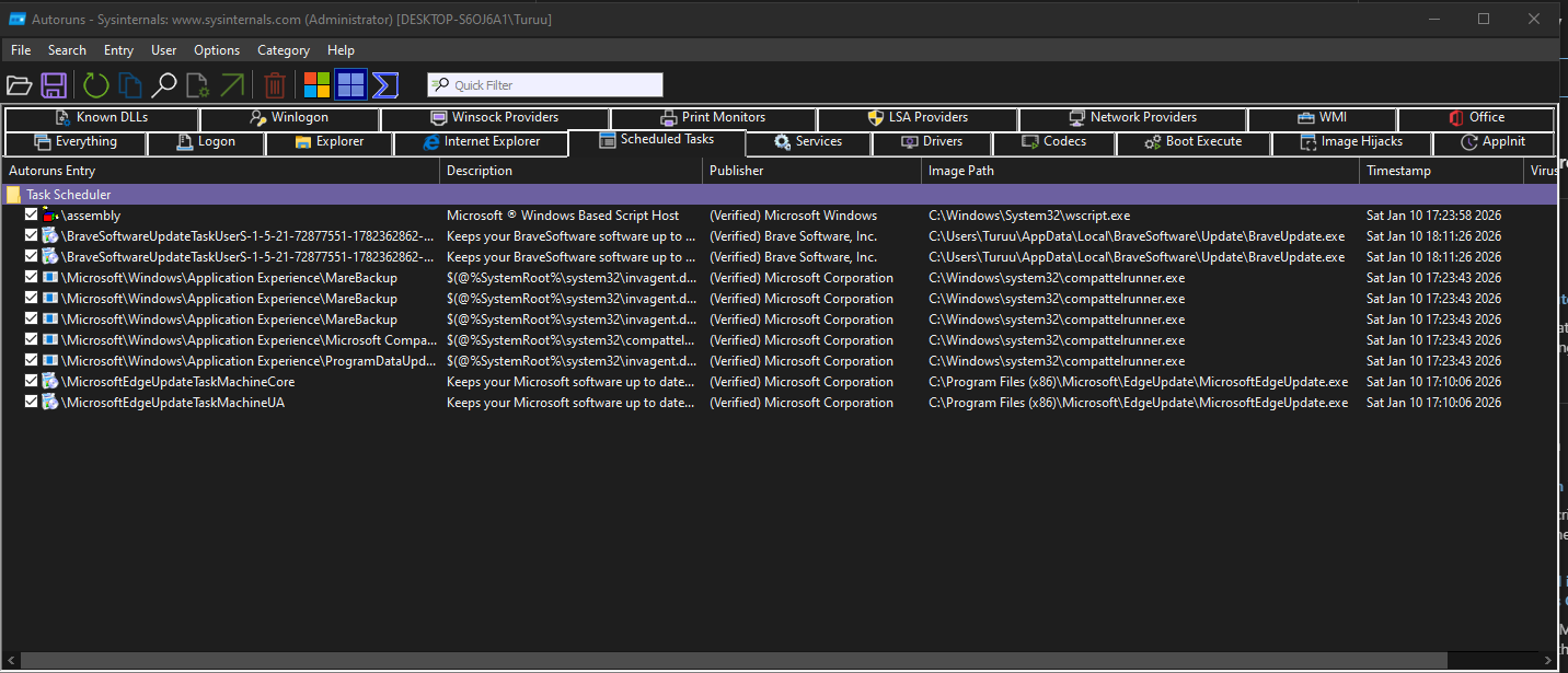

    2
    Select the 'Scheduled Tasks' tab at the top of Autoruns.
