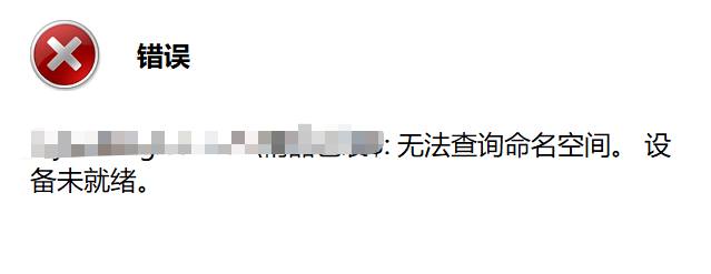

The window server 2019 namespace cannot be deleted. When deleting a namespace, an error message appears stating that the namespace cannot be queried and the device is not ready, as shown in the figure. The reason for this issue is that the domain control component was removed and reinstalled, during which the server name was changed.User's image

    Based on your description, this issue is very likely not a simple permission or operational problem. Instead, it is typically caused by inconsistent or corrupted DFS Namespace configuration data in Active Directory or the local registry after environment changes. When a domain controller is reinstalled or a server is renamed, DFS may still retain references to the old server, which leads to failures when querying or deleting the namespace. Therefore, even if everything looks normal in the GUI, the namespace may still be stuck in a broken state.
    In this situation, you can try the following solutions:
    1. Force cleanup DFS Namespace and recreate it:
    Open Command Prompt as Administrator and run dfsutil /pktflush and dfsutil /spcflush to clear DFS cache. Then try to force remove the namespace using dfsutil root remove \\domain\namespace. If it still cannot be removed, go to the registry path HKEY_LOCAL_MACHINE\SOFTWARE\Microsoft\DFS\Roots and delete the corresponding namespace key. After that, restart the DFS service (net stop dfs and net start dfs) and recreate the namespace. Since this issue is usually caused by corrupted configuration, Microsoft also indicates that removing and recreating the namespace is often the most effective solution.
    1. Check and fix missing or corrupted registry entries:
    Verify the registry path HKEY_LOCAL_MACHINE\SOFTWARE\Microsoft\DFS\Roots\Standalone (or domain-based path) and ensure required values such as ID and Svc exist. If these values are missing, the namespace cannot be queried . If you have a backup, you can restore the correct registry entries; otherwise, in most cases, the namespace cannot be repaired directly and must be deleted and recreated.
    In summary, this problem is usually caused by DFS metadata inconsistency after domain controller changes or server renaming. It cannot be resolved through normal GUI operations alone, and the most practical and reliable approach is to clean up the broken configuration and recreate the namespace.

    The error "The namespace cannot be queried. The device is not ready for use" when trying to delete a DFS namespace typically occurs because the DFS Namespace server cannot correctly reach domain controllers over LDAP, or because the namespace configuration on the server is corrupted (for example after removing/re‑installing DC roles or changing the server name).
    Use the following steps to cleanly remove or recover the namespace:
    1. Verify DC/LDAP connectivity
      • Ensure the current domain controller(s) are reachable from the DFS Namespace server over TCP/UDP port 389.
      • Make sure the PDC or another DC is online and that firewalls allow LDAP traffic.
      • After fixing connectivity, close DFS Management, reopen it, and try deleting the namespace again.
    2. If the namespace configuration is corrupted Because the DC role was removed/reinstalled and the server name changed, the local DFS namespace configuration may no longer match Active Directory or the stand‑alone configuration.
      • If a valid registry backup exists for this DFS namespace root on the server, import that registry key for the DFS namespace root from the backup.
      • If no backup exists and this is a stand‑alone namespace with only a single DFS root server, delete the DFS namespace, perform a DFS namespace cleanup on that root server, and then re‑create the namespace.
      • After importing the registry key or recreating the namespace, restart the DFS Namespace server or at least restart the DFS service so the updated registry data is loaded.
      • Reopen DFS Management and then delete or reconfigure the namespace as needed.
    3. General DFS namespace troubleshooting
      • If other "The namespace cannot be queried" errors appear (for example, domain cannot be contacted, RPC errors, element not found), follow the corresponding guidance in the DFS Namespace troubleshooting article referenced below.
    These steps address both the LDAP/DC reachability problem and the corrupted DFS namespace configuration that commonly cause this error after domain controller changes.
