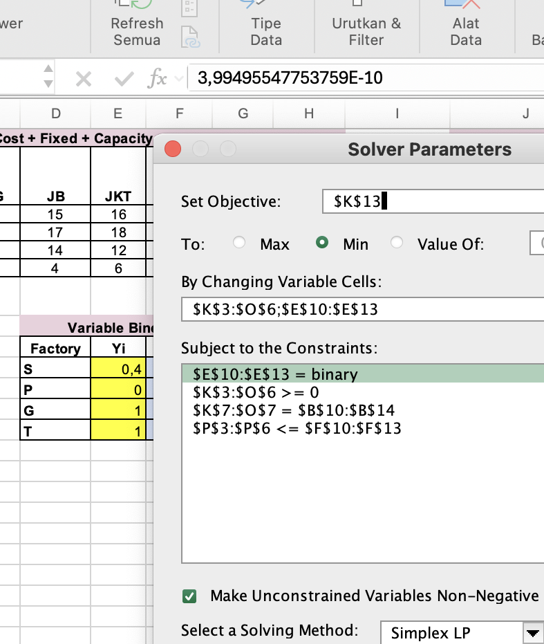

im using solver tools, after that solver parameter panel appear, i do that code or array in subject to the constraint "$E$10:$E$13 = binary" but the result after i press solve is 0,4 in array E10. so is it bug or something i dont know (very newbie to this). thank you for anyone want to helpJepretan Layar 2026-03-31 pukul 17.25.24

    This is not a bug. It usually happens when the Solver is not strictly enforcing the binary constraint due to the solving method or model setup. Even though you set the cells as binary, getting a value like 0.4 means Solver is treating the problem as a relaxed (continuous) model.
    Make sure you are using the Simplex LP method with all constraints correctly defined, and double-check that the “Make Unconstrained Variables Non-Negative” option is enabled. Also, try re-adding the binary constraint or switching to the Evolutionary method to enforce integer/binary results more strictly.
    In short, it’s a configuration issue, not a bug.
