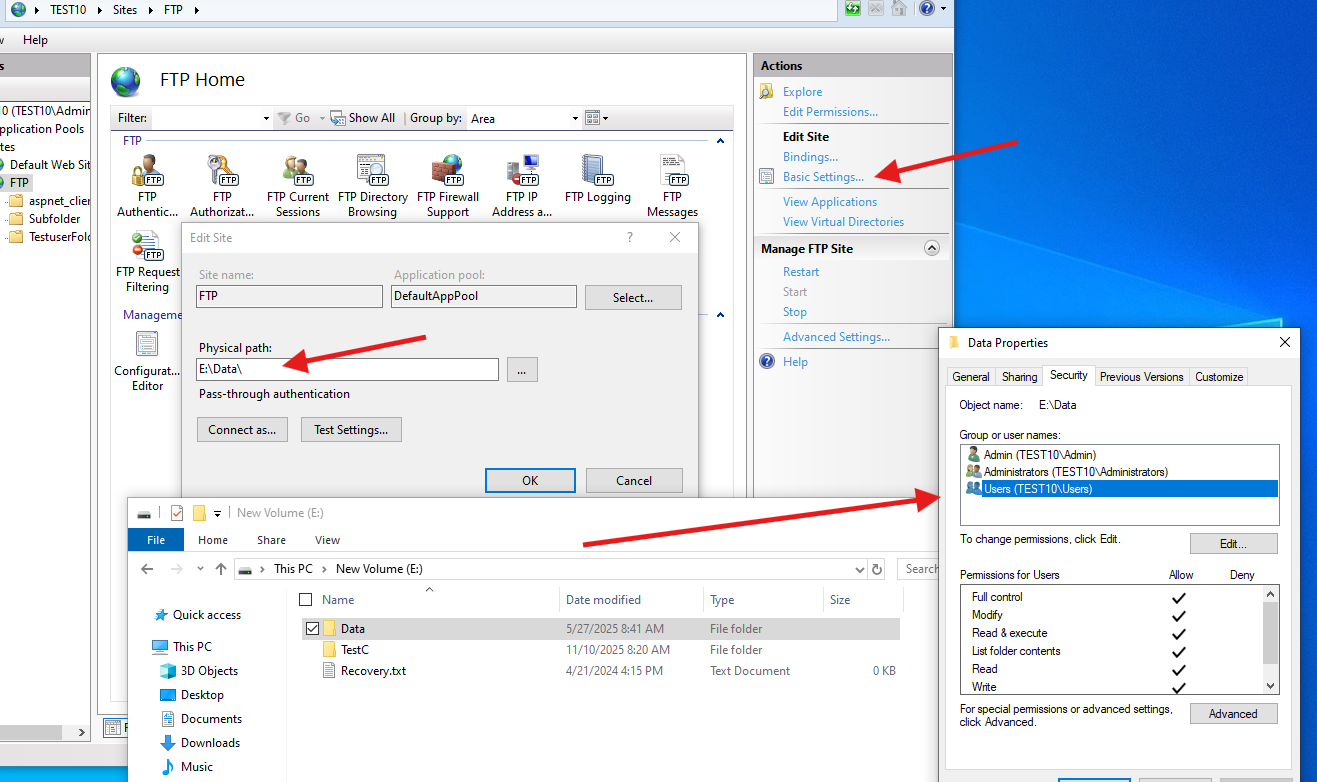

Dear community,
Can somebody please direct me to good theoretic documentation about how IIS Ftp Server should work?
I did everything by the book, but can not authenticate.
I think I tried, trial on error, every possible combination but to no avail.
I think this is a very common issue but were unable to find solutions in Q&A.
All methods of authentication will suffice, but I prefer domain authentication.
Yours sincerely,
Bjarne Petersen

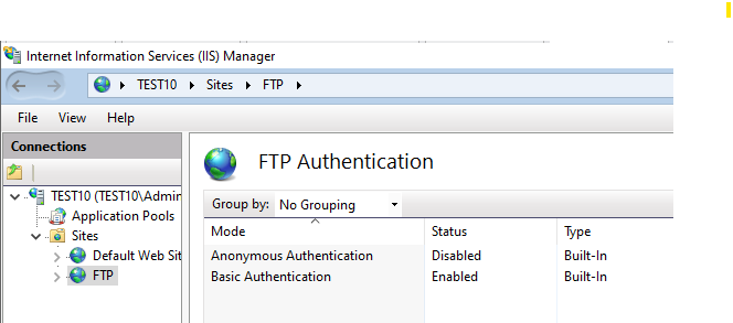

    After setting up the platform, you can configure the FTP site in IIS Manager by pointing a new site to the physical folder you just secured. Since you're dealing with domain credentials, which FTP transmits as plain text by default, you must configure the site binding to require an SSL certificate to encrypt the session. For authentication settings, you must enable Basic Authentication and disable Anonymous Authentication, relying on the SSL tunnel to protect the transmission. Finally, you need to navigate to the FTP Authorization Rules, delete any default rules, and add a rule that specifically allows the domain group you created, granting them appropriate read or write permissions.

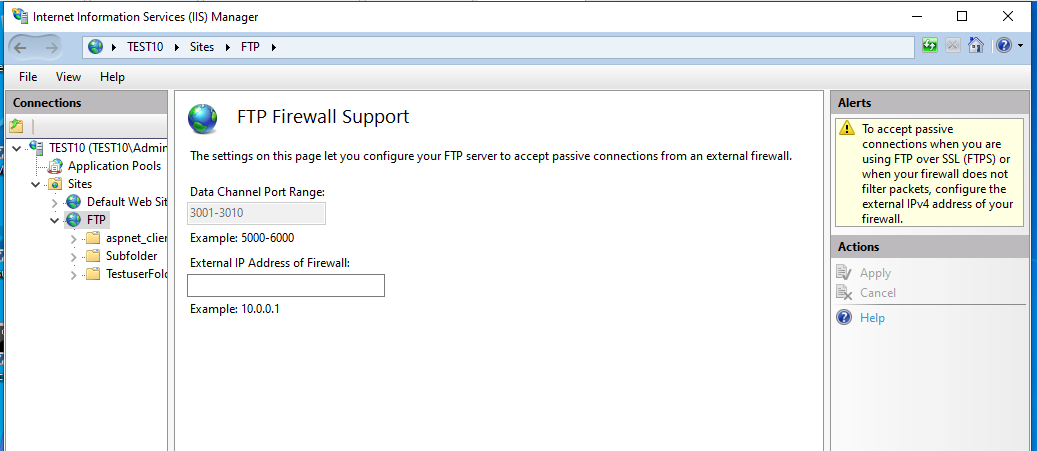

    If you've completed the previous configuration steps and authentication is still failing, there are a few specific areas to investigate. First, verify that FTP User Isolation is disabled in IIS, as enabling it requires a very specific subdirectory structure tailored to each domain user, which will cause logins to fail immediately if those directories are missing. Next, confirm that both port 21 and your specified passive port range are allowed through the Windows Firewall. If network traffic is still active but authentication fails, the Windows Event Viewer Security logs will be the best diagnostic tool, as the error events checked will reveal specifically whether the problem stems from an incorrect password, a locked Active Directory account, or a lack of local login permissions on the server itself.
