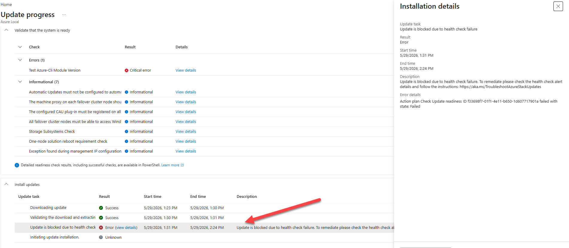

Detect known incompatible Azure CLI extensions that should be removed.
Joe Comeau 40 Reputation points
2026-05-14T17:56:51.9166667+00:00
The error message is not very verbose on what extensions should be removed
We cannot go thru with the update process on this.

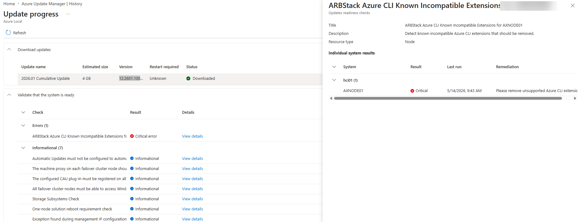

    Azure Update Manager is blocking the update because at least one Azure CLI extension installed on the node is on a “known incompatible” list for that update. The readiness check, however, doesn’t enumerate which one, so the unsupported extensions must be identified and removed manually from the node’s Azure CLI.
    Use the Azure CLI extension management commands on the affected node (AXNODE01 in the screenshot):

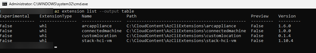

    1. List all installed extensions
         az extension list --output table
      This shows every extension currently loaded into the Azure CLI on that node.
    2. Remove non-required or suspect extensions For each extension that isn’t required for Azure Stack HCI / Azure Local operations, remove it:
         az extension remove --name <extension-name>
      If an extension was installed from a custom source and is not in the official list of Azure CLI extensions, it is a strong candidate for removal.

    4. Re-run the readiness check After removing nonessential extensions, re-run the Azure Update Manager readiness checks for the 2026.01 cumulative update. If the error persists, continue pruning extensions until only the core, required ones remain.

    This process systematically removes unsupported or obsolete Azure CLI extensions so the “ARBStack Azure CLI Known Incompatible Extensions” readiness check can pass and the update can proceed.
