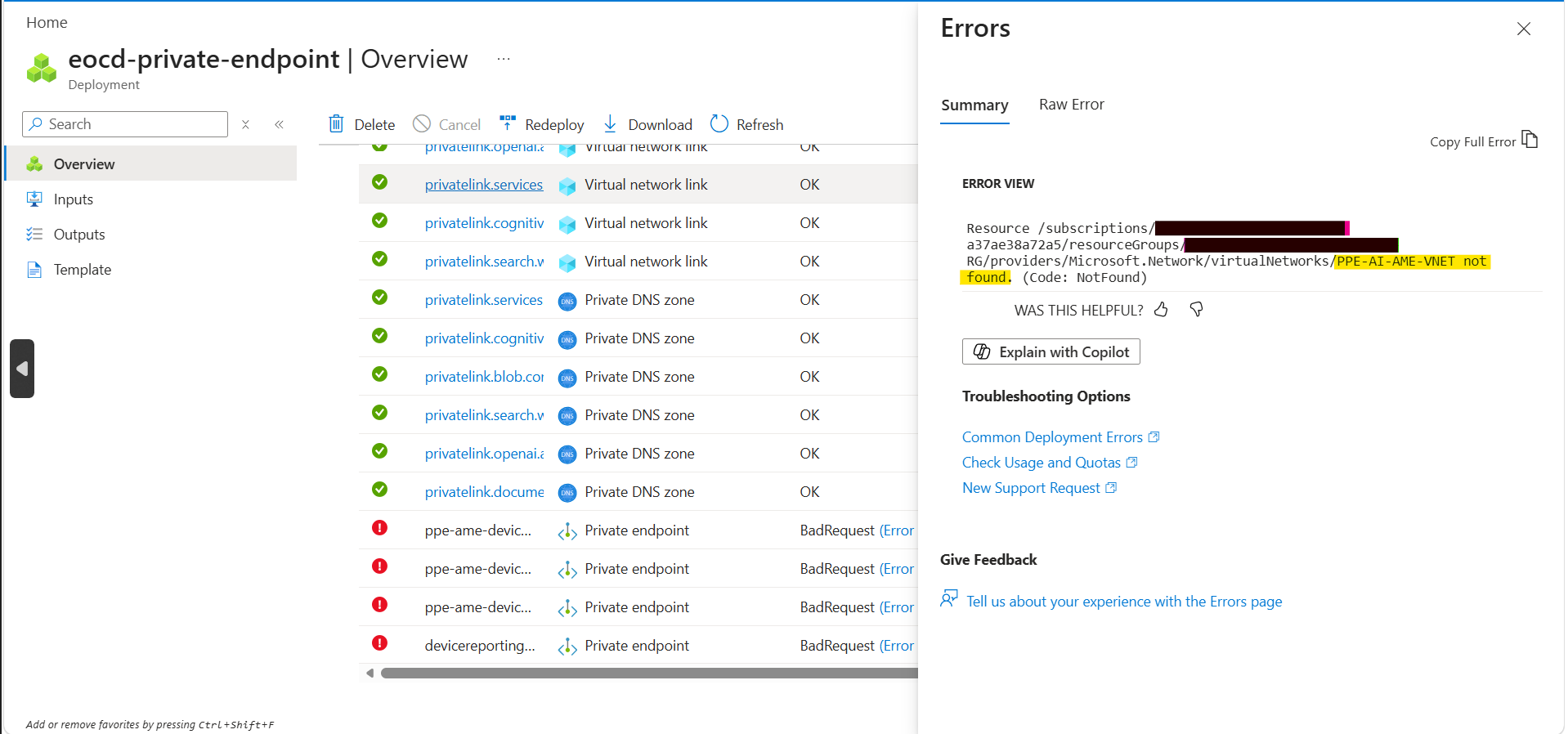

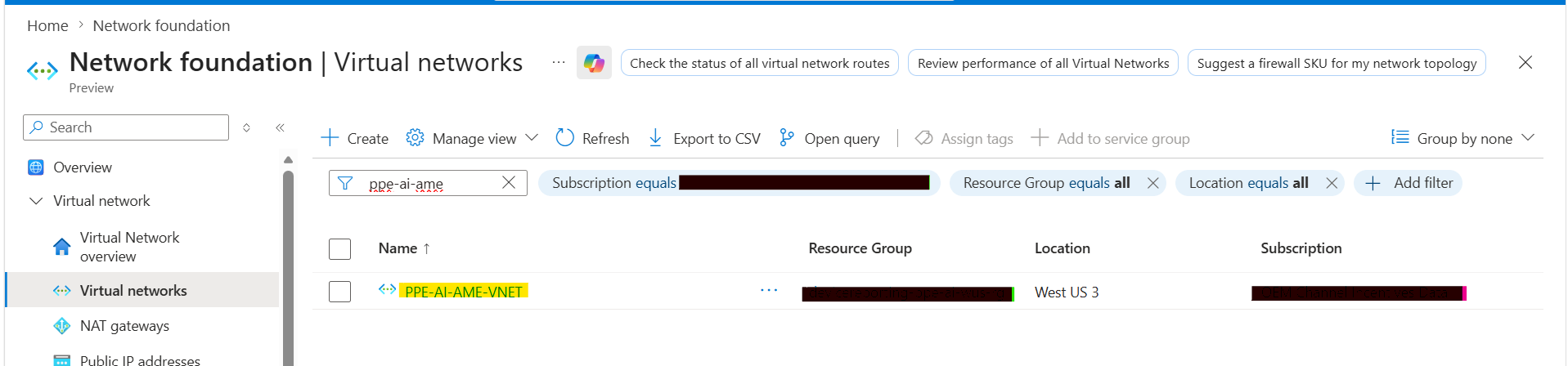

When trying to deploy Foundry agent through template present on github "Microsoft Foundry: Standard Agent Setup with E2E Network Isolation template", private endpoint creation fails with error "vnet not found" whereas the vnet is present and is visible on portal. Please suggest if there is any issue with template.Screenshot 2026-06-15 074936

    The observed behavior indicates a reference resolution issue rather than an actual VNet absence, most likely caused by parameter or scope mismatch.
    From the information provided, the virtual network is clearly present and accessible in the portal. At the same time, supporting resources such as virtual network links and private DNS zones have been successfully created. This combination strongly indicates that the failure is not due to a missing virtual network, but rather due to the deployment process being unable to resolve the virtual network reference correctly during private endpoint creation.
    The error “virtualNetworks … not found” typically occurs when the template references a virtual network using parameters that do not exactly match the resource at deployment time. This includes mismatches in identifiers, scope, or expected format.

    2. Confirming region alignment For network-isolated agent deployments:
      • The Foundry resource and the virtual network must be deployed in the same Azure region
      A region mismatch can cause failures specifically during private endpoint provisioning.

    6. Reviewing deployment operations To identify the exact mismatch:
      1. Navigate to: Resource Group > Deployments > Failed Deployment > Operations
      2. Review the failed private endpoint step
      3. Capture:
        • Full error details
        • Resource ID being referenced
        • Parameter values used
        This view typically reveals the exact reference mismatch.
    After aligning the configuration and redeploying, the issue should be resolved.

  2. Ojas Chopade (V-OCHOPADE) 0 Reputation points
    2026-06-16T09:59:06.5266667+00:00
    Resource group and vnet was in different region causing the issue. Thank you for your suggestion! The deployment succeeded now! :)
