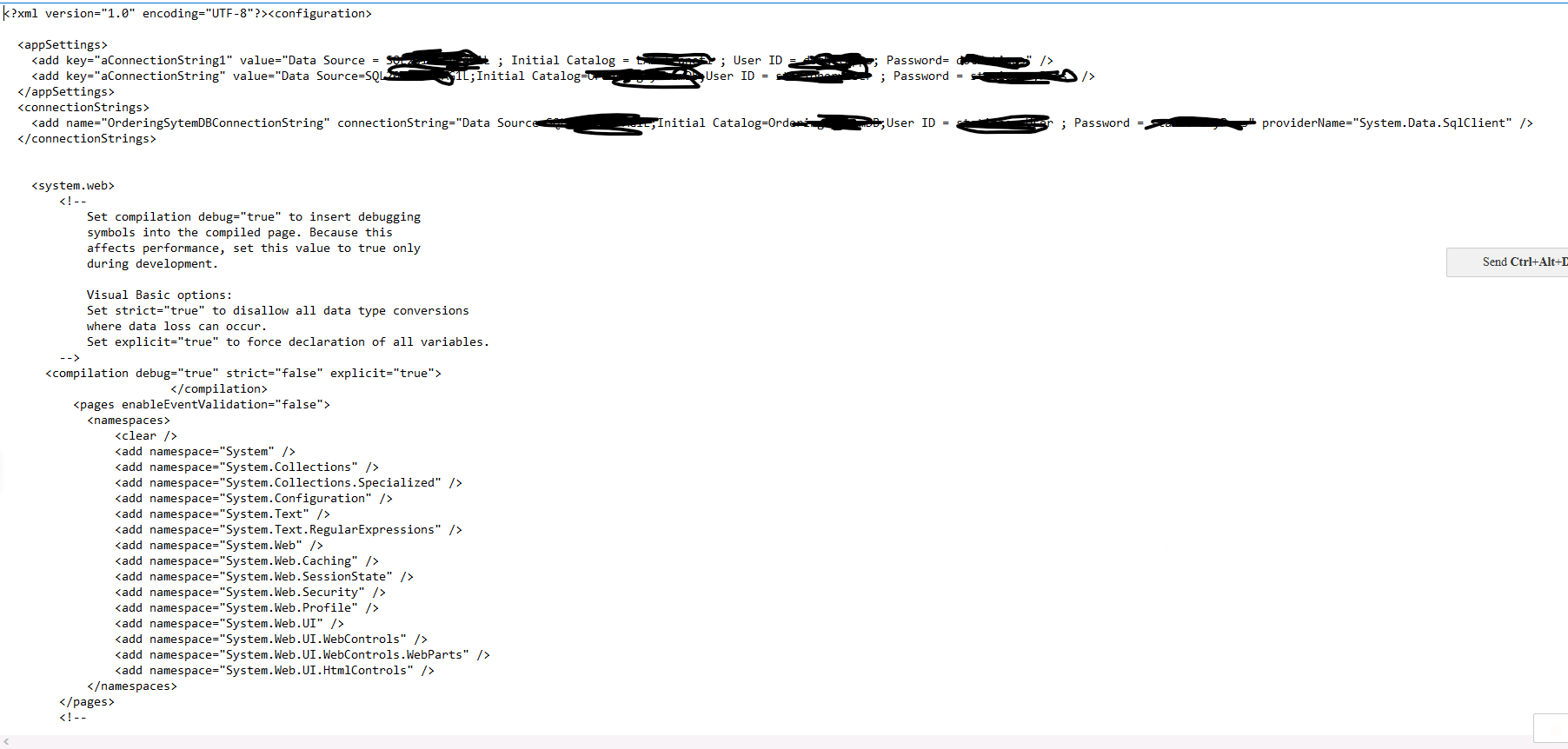

    Ok, are you able to see web config file. if available share screenshot suppose any password is there just blur it and share .
  4. Chacko, Santhosh 5 Reputation points
    2026-06-22T13:49:54.1433333+00:00
    @Senthil kumar
    The application user suddenly lost his admin access. No admin setup maintained in db or in config file. We have access to the aspx files, but can't troubleshoot the issue as no visual studio dotnet installed in the server.

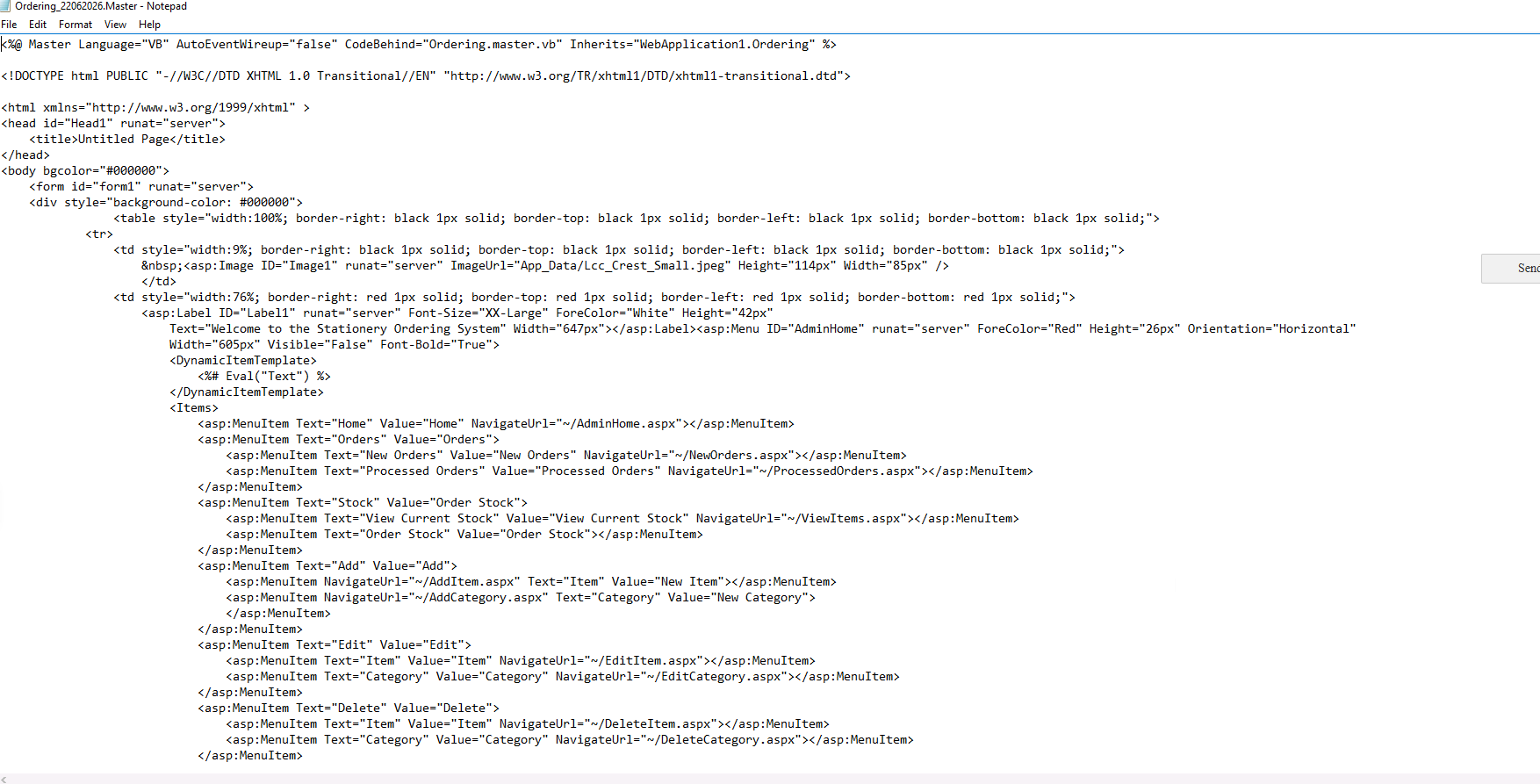

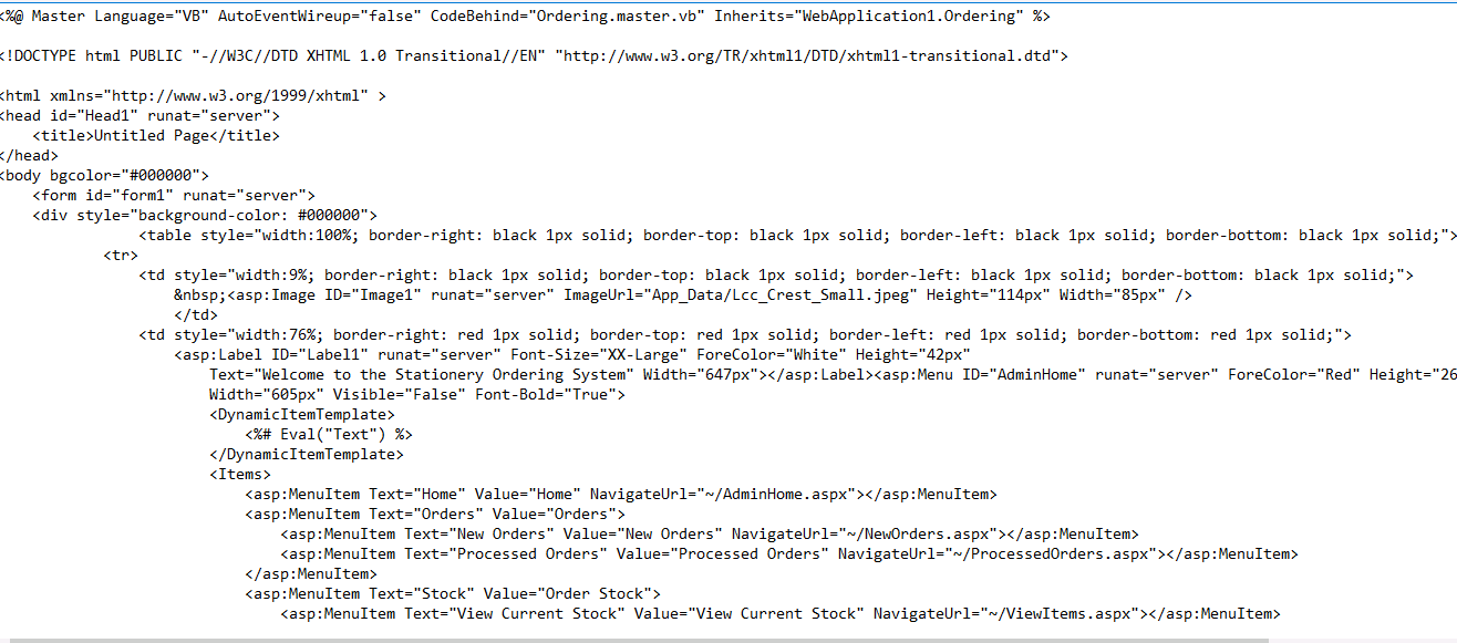

  5. Chacko, Santhosh 5 Reputation points
    2026-06-22T13:36:57.2466667+00:00
    Hi @Senthil kumar
    Its vb.
    Also master pages created for this applicaiton
    Thanks
    Santhosh
