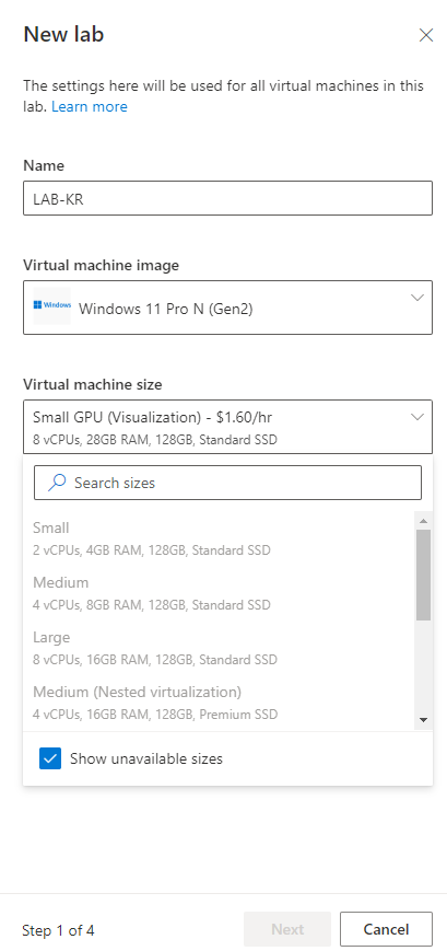

if the azure lab service resource location is USA area, well doing to select all VM size. But if the location is KR central, it can't be select small, medium and etc size. Anyone help me to resolve this issue.

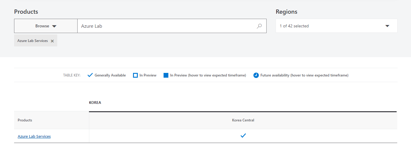

  1. JimmySalian-2011 42,511 Reputation points
    2022-09-23T05:17:20.063+00:00
    Please check the availibility as per the region and compute is the one you are looking I have filtered out for you and hope this helps.
    products-by-region
  2. JimmySalian-2011 42,511 Reputation points
    2022-09-23T07:20:31.78+00:00
    Hi
    Some regions also have restricted view so I will advice to raise a support case with Microsoft create-ticket
  3. Elizabeth Maher 251 Reputation points Microsoft Employee
    2022-11-03T17:25:43.507+00:00
    @Anonymous ,
    If you are using a lab plan based lab, it's possible that no quota the region you chose. Please follow instructions at https://learn.microsoft.com/azure/lab-services/how-to-request-capacity-increase?tabs=Labplans to request a quota increase.
    Hope that helps,
