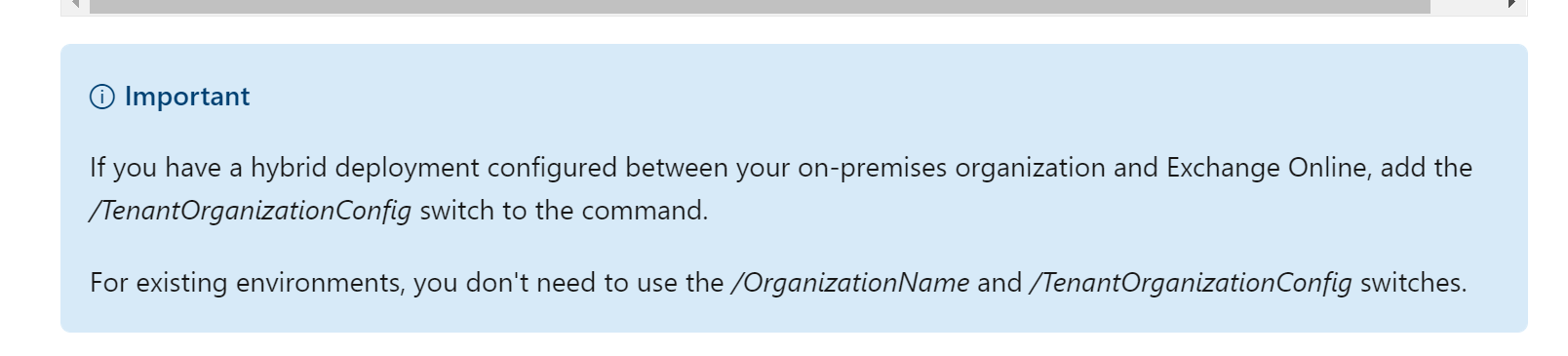

    Why the need to run that switch?
    Its not required in an existing hybrid environment
    https://learn.microsoft.com/en-us/exchange/plan-and-deploy/prepare-ad-and-domains?view=exchserver-2019
