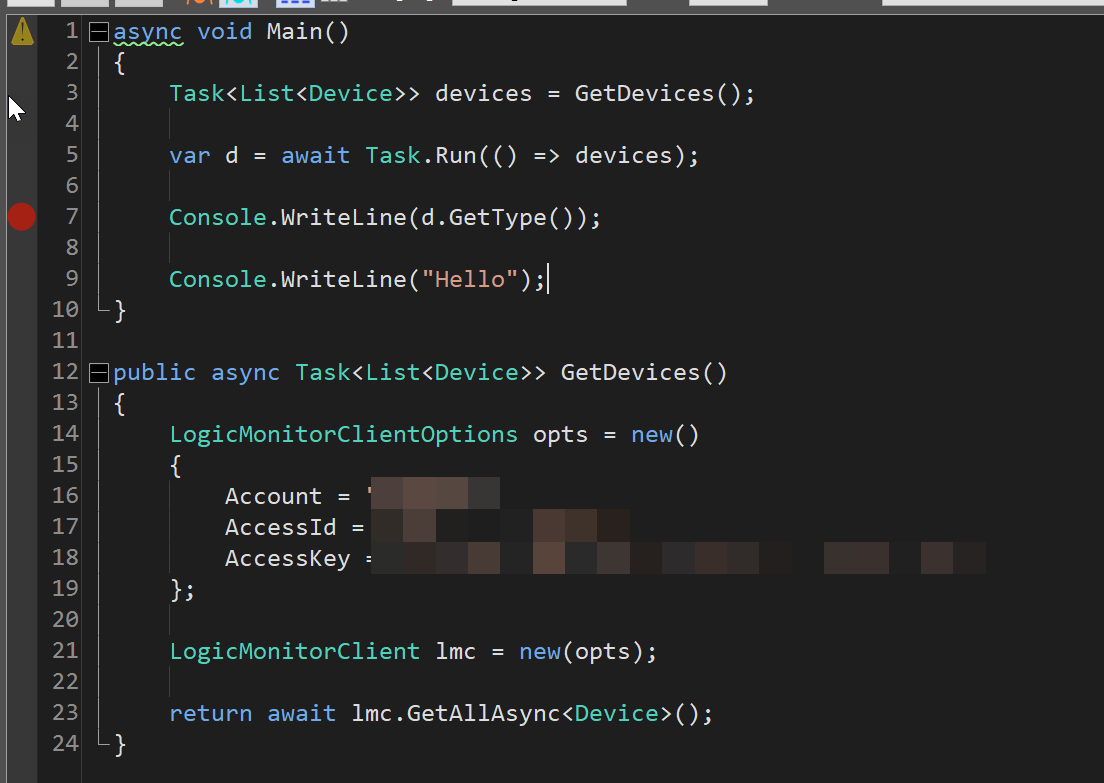

Can anyone please tell me why the code on lines 7 & 9 does not get executed?
I'm basically pulling back a list of devices using the LogicMonitor SDK and there is no synchronous version of GetAllAsync (in the SDK) .
This is a cut-down version of my code in VS2022 which also does not execute after the line 5.
Is there a better/proper way to do this?
Thanks

    You can do this on line 3:
    List<Device> devices = await GetDevices();
    Then you don't need line 4 and simple have:
     Console.WriteLine(devices.GetType());
    Console.WriteLine("Hello");
    I think this should work.
