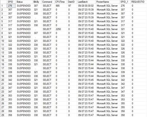

This is being called at the start of an SSIS package and 15 of these packages are running in parallel. Looking at sp_who2 I'm seeing:
  • 307 is partially blocked by 321 and 338
  • 321 is partially blocked by 307
  • 338 is partially blocked by 321
  • the other sessions are blocked by 321 and/or 338
