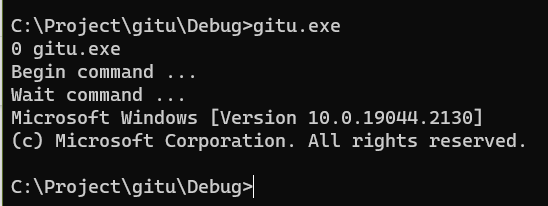

So, if I run this app, from command line window:

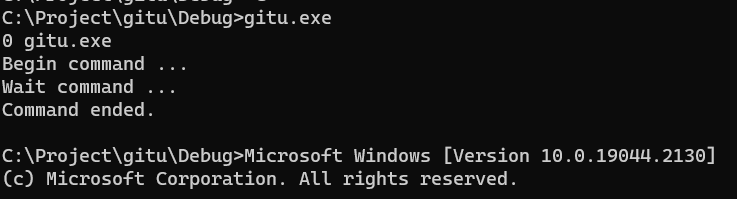

So, looks like never reach Command ended point, seems like WaitForSingleObject is block the program flow. If I remove WaitForSingleObject call, the app will show it will be reach end of the program:
But, I need to know when the my command, in this test case, ipconf /all is done, so, I really need this WaitForSingleObject call. I have took this code from here: https://learn.microsoft.com/en-us/windows/win32/procthread/creating-processes

  1. Castorix31 90,686 Reputation points
    2022-11-23T10:59:18.417+00:00
    You forgot /C :
    std::string cmdLine("cmd /C ipconfig /all");
1 additional answer
  1. Flaviu_ 1,031 Reputation points
    2022-11-23T10:59:43.043+00:00
    Yes, it goes now, when I removed cmd word from command. Thanks.
