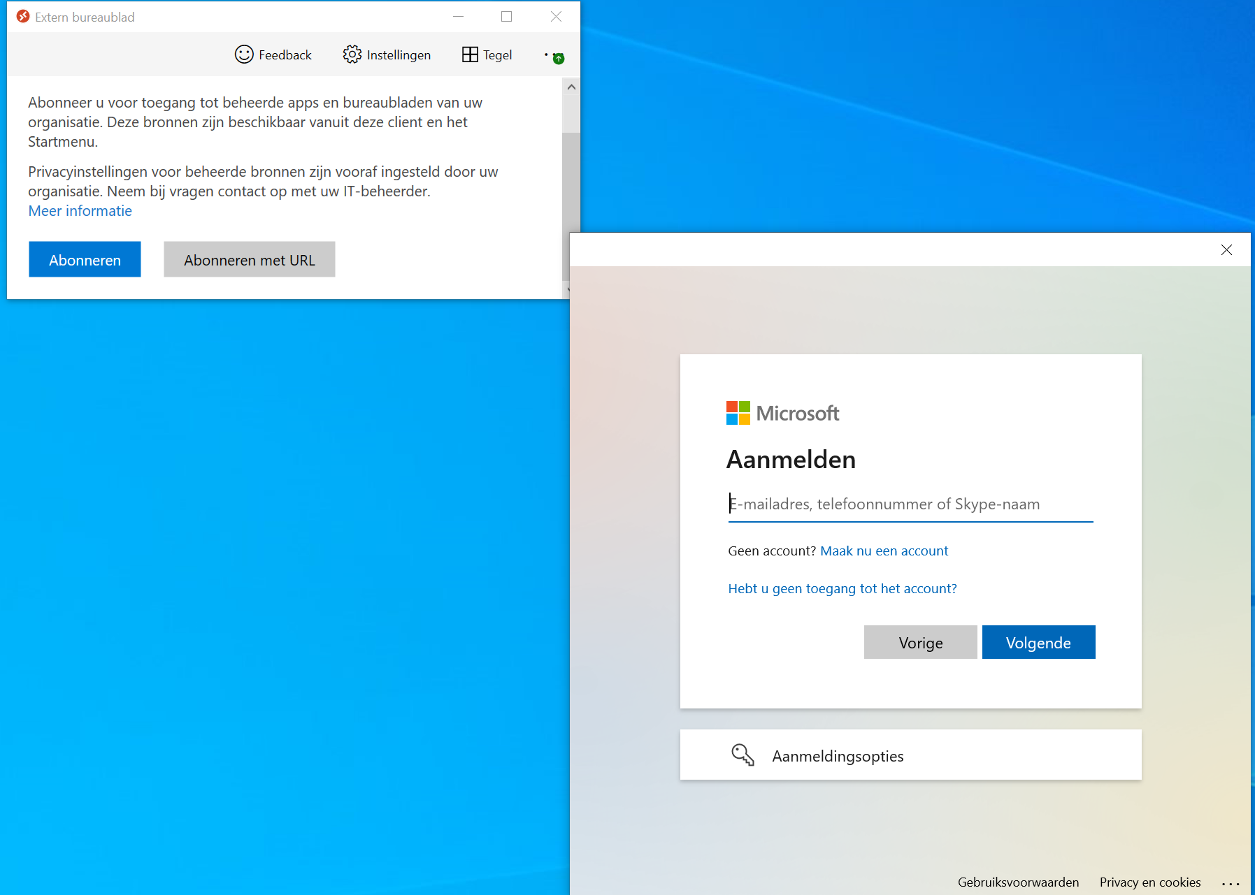

on some computers in our network we get a blank popup window where we normally insert our login credentials to have access to AVD.
Toon Brusten 26 Reputation points
2022-12-02T19:43:03.72+00:00

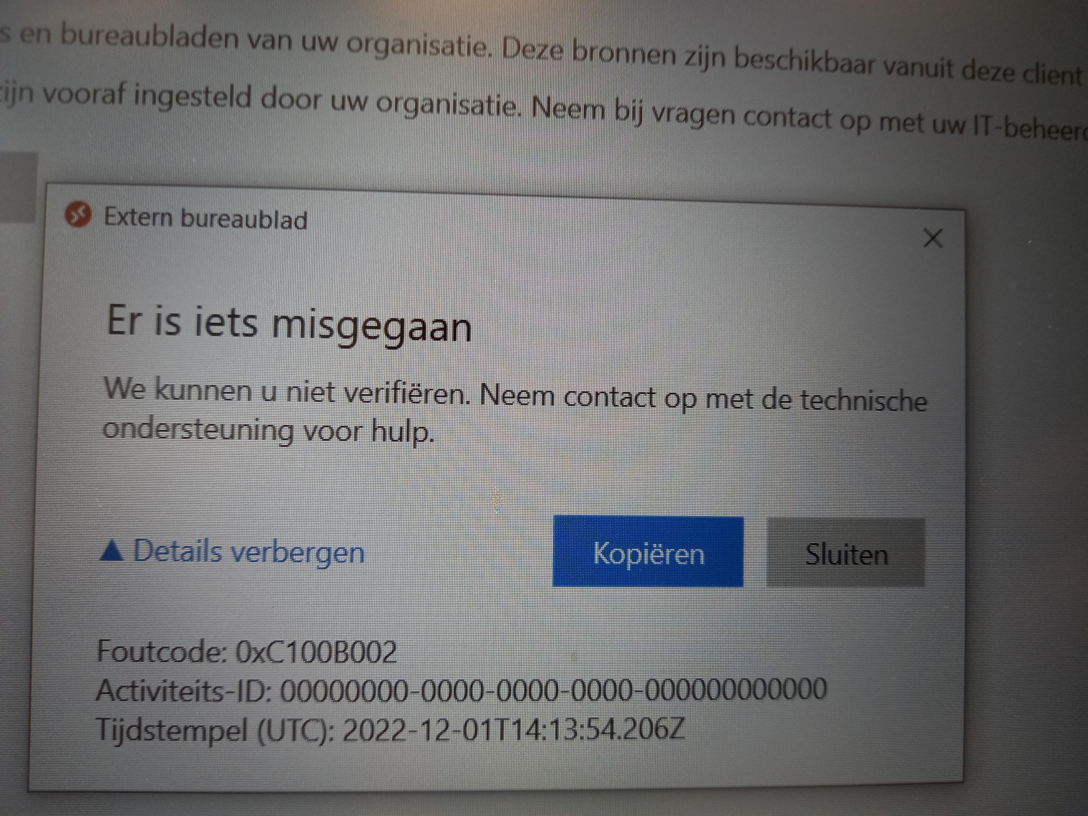

After clicking on subscribe (abonneren in Dutch) in the azure virtual desktop client app (remote desktop) we get on some computers in the network a blank login credential popup screen and an error so it is impossible to login avd from that computer. See the included images.
Hoping you have an idea for a solution.

    Update: (Thank you, @Toon Brusten ) It looks like this was caused by the MPSSVC component of Windows Firewall not running only on the affected devices. This was fixed with an add in the registry.
    1. AAD authentication is blocked. This type of issue is usually caused by something on the device that is blocking AAD authentication (e.g., a proxy and firewall). The first step would be to determine if ADFS is used to authenticate and if so, it may be that the DNS resolution of your ADFS server doesn't work from that device.
    2. Cumulative Updates are not installed. This is especially true when it appears to be just a few devices that are running into this issue. Check to make sure that Cumulative Updates have been installed.
    Reported by @Toon Brusten :
    External desktop
    Something went wrong
    We can't verify you. Contact technical support help.
    Error code: 0xC100B002
