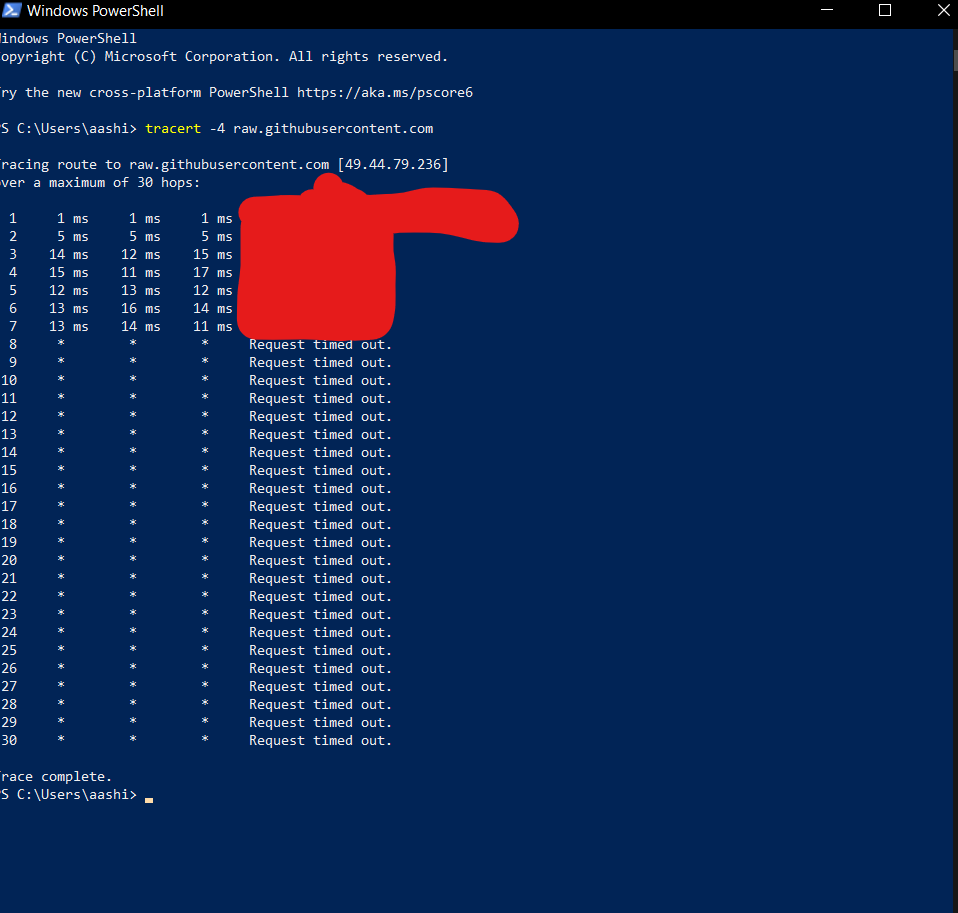

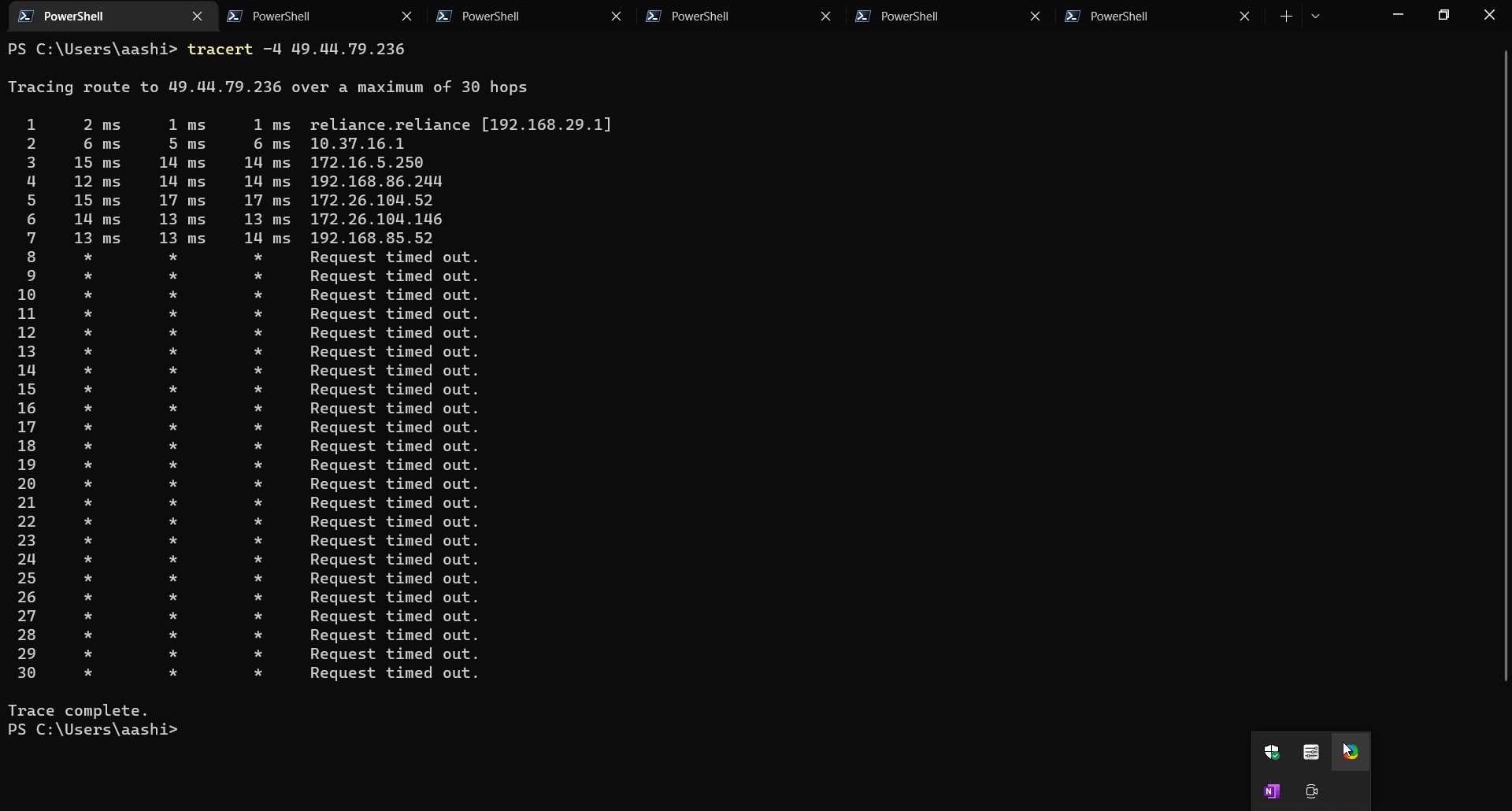

    Go find a friend and see if their PC resolves raw.githubusercontent.com to that IP address.
    Did you do that? Have someone on another PC in India do an "nslookup raw.githubusercontent.com". What IP do they see? Do they use the same ISP that you do?
    As for these addresses i have tried out in powershell 7.1 and 5.1
    This has nothing to do with any version of powershell. It is a networking issue.
    As for the Problem with ISP can you be more detailed on this part as i am quite new in this field.
    The question is: why does raw.githubusercontent.com resolve to 49.44.79.236 on your pc?
    I used Nmap to analyze that IP and it found 2 open ports, 554 and 7070. HTTP and HTTPS are NOT open. That is not a web server. Nmap reports that it is probably a cable modem.

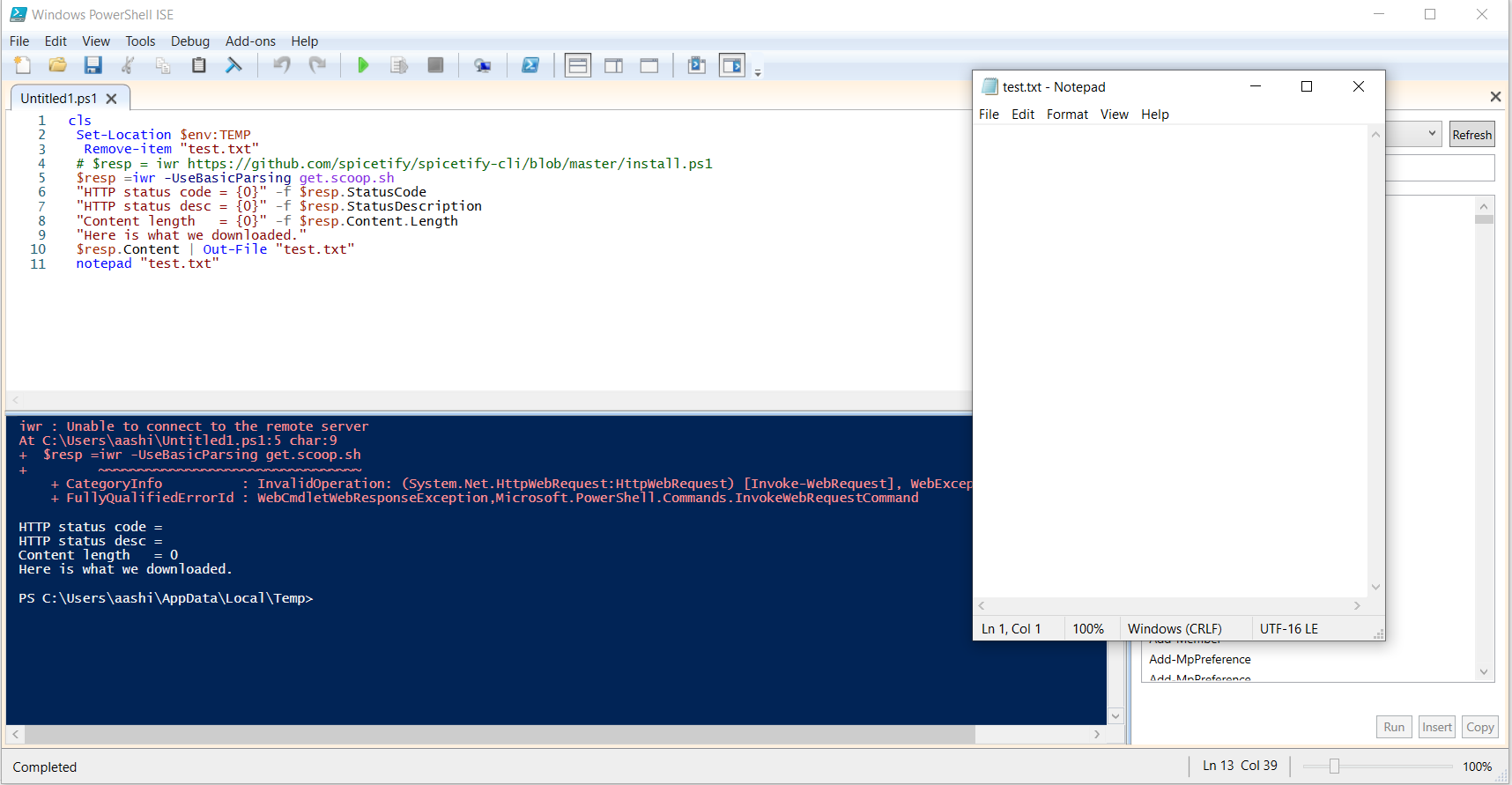

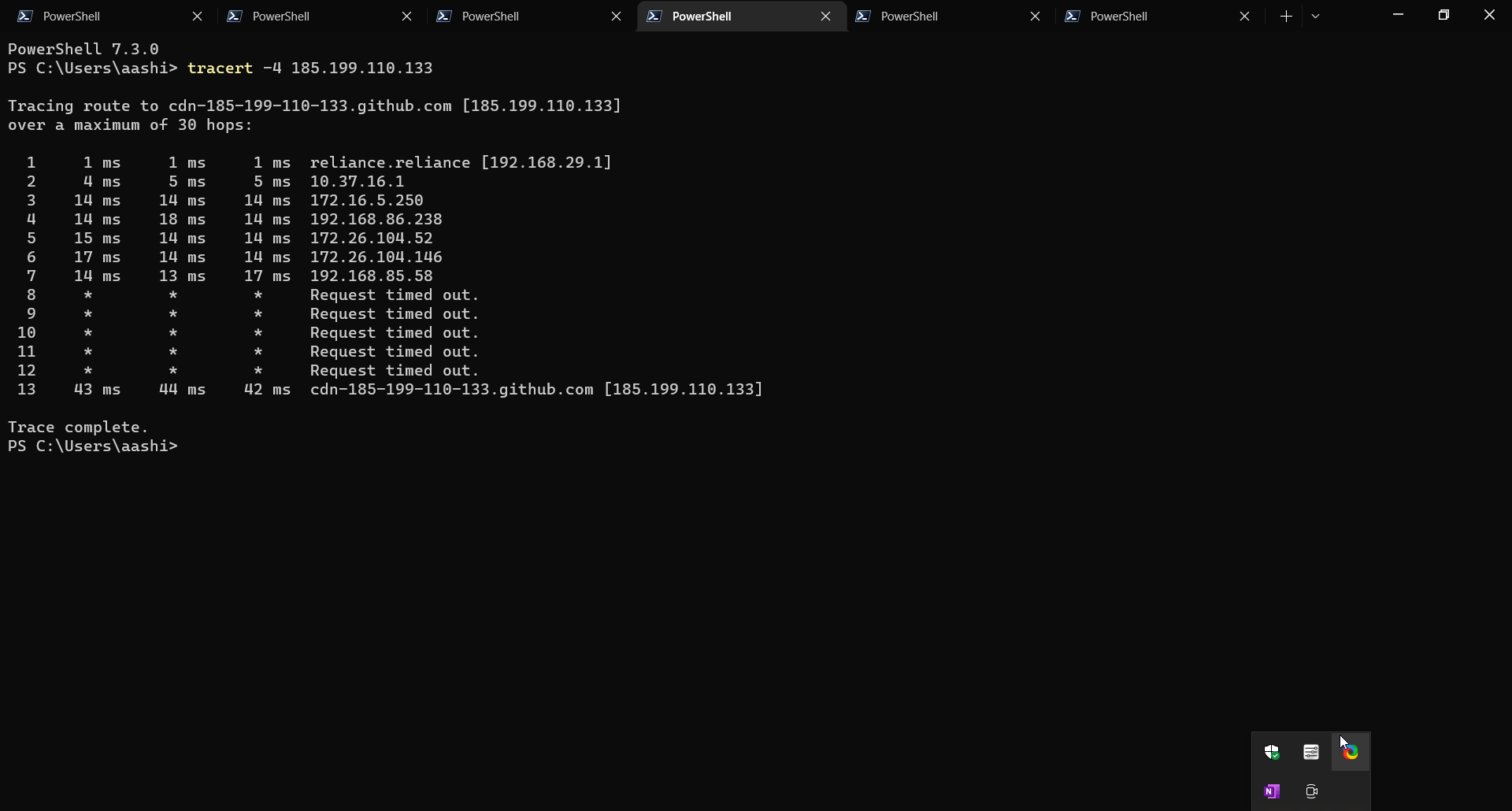

  3. aashish kumar 26 Reputation points
    2022-12-09T18:17:41.073+00:00
    Hey @MotoX80
    i tried to Run the script as you instructed and as expected iwr/irm command is not downloading the script and saving it in temp folders text.txt file
    Please check the images Out
  4. MotoX80 36,416 Reputation points
    2022-12-10T01:42:44.367+00:00
    It would appear that the server in India is offline.
    https://whatismyip.live/ip/49.44.79.236
    In the US, I get a different set of IP addresses.
    PS C:\> nslookup raw.githubusercontent.com
    nslookup : Non-authoritative answer:
    At line:1 char:1
    • nslookup raw.githubusercontent.com
    • CategoryInfo : NotSpecified: (Non-authoritative answer::String) [], RemoteException
    • FullyQualifiedErrorId : NativeCommandError
    Server: Wireless_Broadband_Router.home
    Address: 192.168.1.1
    Addresses: 2606:50c0:8000::154
    2606:50c0:8001::154
    2606:50c0:8002::154
    2606:50c0:8003::154
    185.199.111.133
    185.199.108.133
    185.199.109.133
    185.199.110.133
    PS C:\> iwr 49.44.79.236
    iwr : Unable to connect to the remote server
    At line:1 char:1
    • iwr 49.44.79.236
    • CategoryInfo : InvalidOperation: (System.Net.HttpWebRequest:HttpWebRequest) [Invoke-WebRequest],
      WebException
    • FullyQualifiedErrorId : WebCmdletWebResponseException,Microsoft.PowerShell.Commands.InvokeWebRequestComman
      d
    PS C:\> iwr https://49.44.79.236
    At line:1 char:1
    • iwr https://49.44.79.236
      WebException
      d
